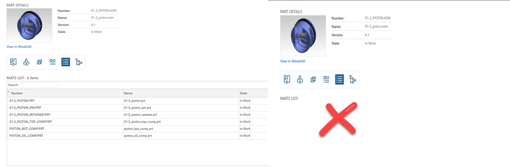

The Advanced Grid Extension provide flexible, interactive ways to display data in grid views. Grid widget supports numerous ways to render column data and allows on-the-fly configuration of the data display. Advanced grids provide options to allow fully dynamic grid configuration.
For more information refer to Advanced Grid Widget Extension Guide.
Not having Advanced Grid Extension package will result in Blank Table while viewing Windchill Data in ThingWorx Navigate Apps.
See Below Images with and without Advanced Grid Widget.
