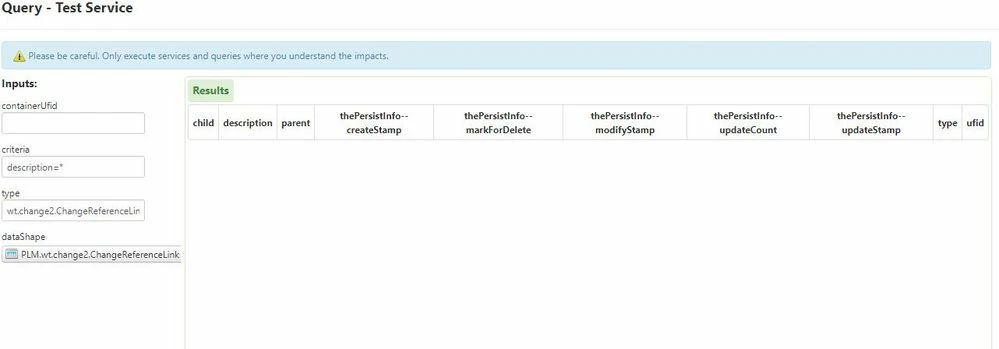

Hi developers,
I have a requirement to display the ECN along with its associated ECR. I found the link types namely:
  1. wt.change2.ChangeProcessLink
  2. wt.change2.AddressedBy2
  3. wt.change2.ChangeReferenceLink
 In Thingworx under "ptc-windchill-demo-thing" i'm using "Query" service for my use case as shown below for all the link types:
child and parent columns are emptychild and parent columns are emptychild and parent columns are empty
No rows are populatedNo rows are populatedNo rows are populatedNo rows are populatedNo rows are populatedNo rows are populated
I'm unable to get all the associated change objects. When i searched with  "wt.change2.ChangeProcessLink" type I'm not able to get the child and parent details without which the service will become irrelevant to my use case.

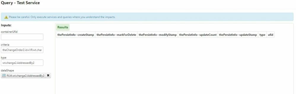

Hi @JeffZemsky ,
Thanks for your reply. I'm currently using "11.1 M010" version of windchill.
I have earlier tried to query with AddressedBy2 with the following details:
criteria:
theChangeOrder2.id=<VR id>
type:
dataShape:
<Proper Datashape>
The "Query" service in "ptc-windchill-demo-thing"returns a null infotable(as shown in my first comment). I have validated in windchill that the Change Notice(mentioned in the criteria) has a link with Change request.

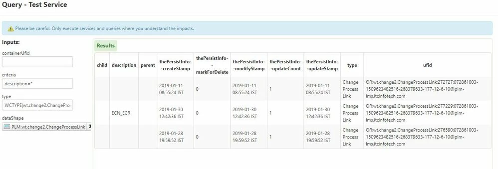

With the same "Query" service if i try with "wt.change2.ChangeProcessLink" as type i get the link ufid only and not the CN or CR ufids (with which i can get the relevant details like name, number, version, etc)
Also i found that in criteria for the "Query" service i can only provide logical attributes that are listed under the type class in "LogicalAttributes.xml".
Within this file only "wt.change2.AddressedBy2" class is there and no "wt.change2.ChangeProcessLink" is given. So I'm not able to get the attributes for "wt.change2.ChangeProcessLink" with which i have to search for.
