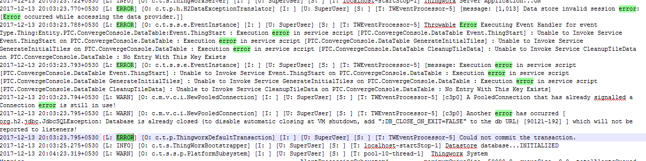

Hi ,
I am using below components after referring Navigate Support Matrix document:
Thingworx 8.0.1 H2,
Thingworx Utilities 8.0.1, Windchill Extension 1.7, Navigate Framework 1.4.1
Windchill 11.0 M030
Note: I have successfully installed patch WCTWXExtension in windchill, I have imported every component and extension without any error as mentioned in guide "Thinworx Navigate Installation and Configuration guide".
I am getting error when I am trying to test the connection by running Validate Connection service in ptc-windchill-integration-connector. ​I am getting status as Failed ​and I am getting some error in application log. I have attached log file.
Can anyone guide/help me with this?

The most helpful log for the failed Validate Connection test is the IntegrationRuntime log, which is usually stored in the same folder that the IntegrationRuntime jar was run from.

Also are you able to run the Integration Runtime successfully? If so, please share the IR logs.
