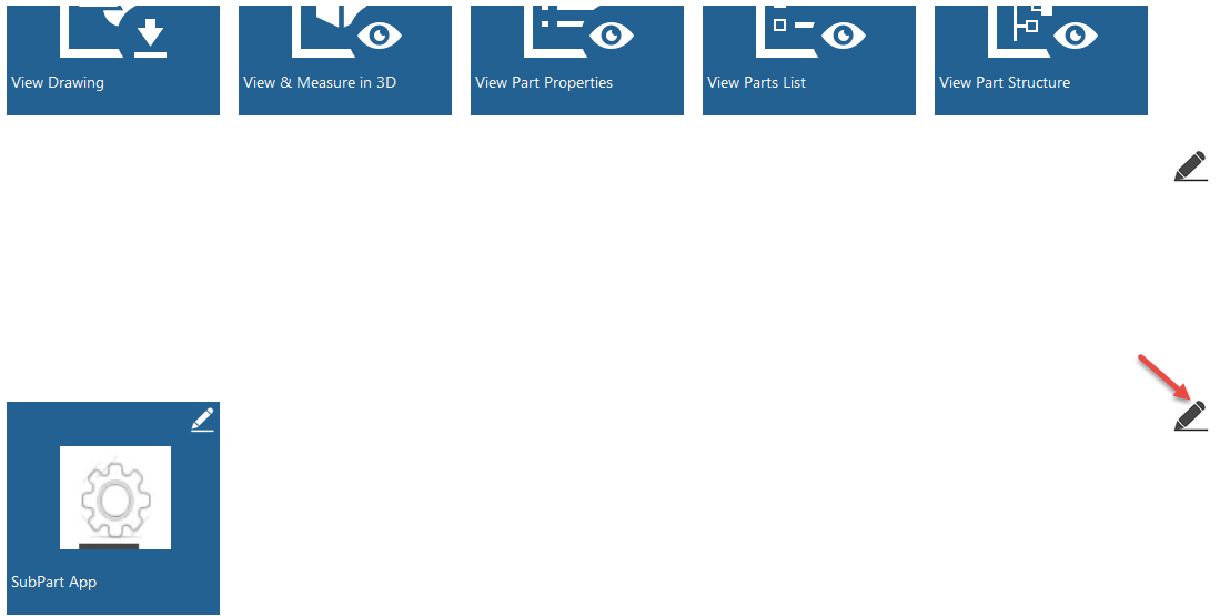

Hi All,
Can anyone provide me documentation to create Tailoring Mashup for the custom apps on Navigate.So, that i can provide access of custom apps to the Manufacturing, Purchasing groups in Thingworx. I am able to get Edit icon, but i don't have Tailoring mashup to provide access to Purchasing and Manufacturing groups as we do for default Navigate Apps.
N.Sivaram.

Hello, Sivaram Nalam.
I discussed you question with a Navigate TSE and we need to know what version of Navigate you have? The ability to give access to customizations in Navigate is a feature new to Navigate 1.5. Is that the version you are using?
Thank you,
-- Craig A.

Hi Craig,
I am using Navigate 1.4. Is their any change in Navigate 1.5 landing page ? Could you please provide me new changes in Navigate 1.5, if any documentation available.
N. Sivaram
