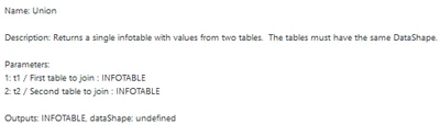

I have 3 infotables, How to join infotables one after another as new infotable.

Method 1: If your infotables are based on the same datashape (or have the same fields) :
You can use the Union function to join two infotables with the same fields.

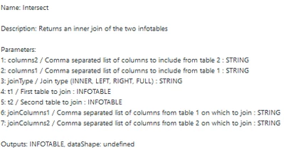

Method 2: If your infotables have different fields and you want to join them like in SQL.
You can use the Intersect function.

Either way, you have to do 2 unions or 2 intersects. First to "combine" the first two infotables. The second command to join your 3rd infotable with the result of the first command.
