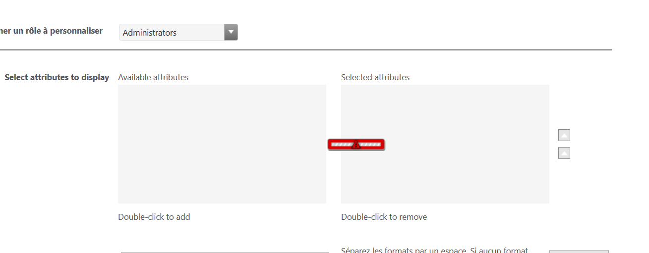

Impossible to Tailoring Part List Attributes
After the Installation of CPS09 on Windchill 11.0 M020,
now I have an error to tailoring Part List Attribute on PTC Navigate 1.4.

[context: com.thingworx.webservices.context.HttpExecutionContext@756817c0][message: Unable to Invoke Service GetDisplayableAttributes on PartsListAccessAppThing : JSON Server error HTTP 404

Thanks for your advices Polina.
I have re-installed the last Windchill Extension (11.0-M020_WCTWXExtension-09.04)  of PTC Navigate and it's OK now.

Please check that all your versions are matching the system requirements guide for Navigate 1.4
HerveBARTHELEMY13-AquamarineAuthorAnswer
Oct 25, 2017 2:40 PM UTC
