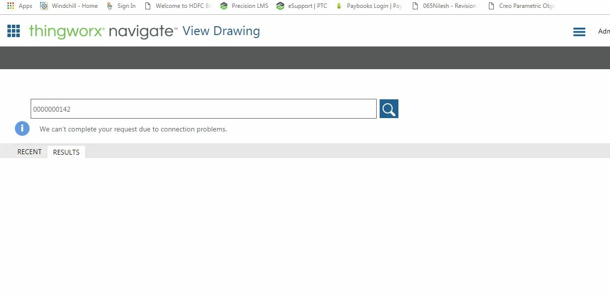

Is SSL is compulsary for thingworx Navigate 1.7 to connect to Windchill M030 ?
I have installed navigate 1.7 .  Also will importing  GridAdvanced3.0.5.zip in thingworx composer was not accepted so i imported grid-advanced_ExtensionPackage-4.1.1.zip.

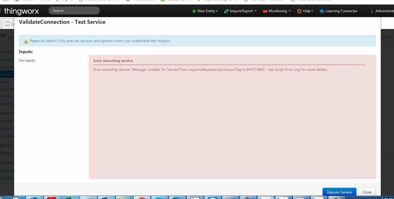

1)  will testing ValidateConnection service from ptc-windchill-integration-connector the result is :
Error executing service. Message ::Unable To Convert From org.mozilla.javascript.UniqueTag to INFOTABLE - See Script Error Log for more details.

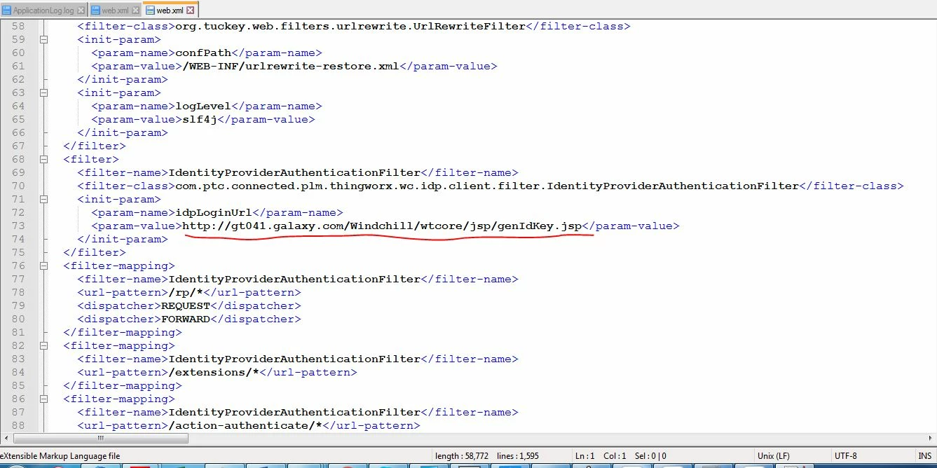

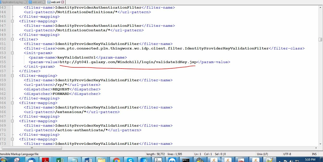

2) As specified in installation document , when i  make changes to  the web.xml file at location  C:\Program Files\Apache Software Foundation\Tomcat 8.5\webapps\Thingworx\WEB-INF
    Thingworx Composer and LandingPageAccessAppMashup both does not opens
3) If i ignore the changes to be made in web.xml file then i can able to view both the pages but  can't connect to  Windchill.

The Windchill Authentication and PingFederate scenarios require Windchill to be configured for SSL, so your only option is to configure for the Fixed Authentication scenario. This will use the login credentials of a specific single user (usually wcadmin) to connect to Windchill, no matter which user is actually logged in to Thingworx. This is unsuitable for a Production environment, but is intended to be used in a Dev environment to get a system up and running with minimum configuration issues.
Navigate 1.7 is designed to work only with grid-advanced-3.0.5-extension. Any other version will fail. Navigate 1.8 is designed to use grid-advanced-4.0.2-extension. No version of Navigate released yet will work with grid-advanced-4.1.1-extension.
Errors in the validateConnection service test will result when you do not have a good connection to Windchill, usually because of a misconfiguration or incorrect certificates.
The changes to the web.xml file at location  C:\Program Files\Apache Software Foundation\Tomcat 8.5\webapps\Thingworx\WEB-INF enable the Authenticator that automatically looks up usernames in WDS by first connecting to Windchill, and then creating a new ThingWorx user if necessary based on the WDS entry. If the Windchill connection is not functioning, no one can log into Thingworx, and the composer and LandingPage will not open. When you do not have this feature enabled (use the original web.xml) then users that have been manually created in ThingWorx can login to ThingWorx. You should not proceed with this step until you have a good connection to Windchill, and the validateConnection test returns "200 - Success".
