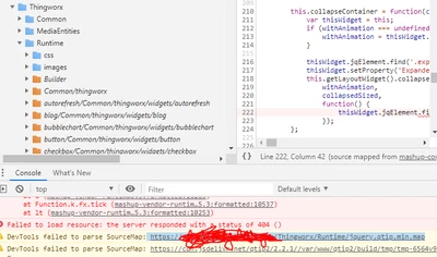

I am trying out  Example1DesignFilesAccessAppConfigThing in TWX Navigate 8.5.3. I was in Composer at
 https://domain.com/Thingworx/Composer/index.html#/modeler/details/Mashup~DesignFilesAccessAppMashup/attributes , and clicked 'View Mashup'.  It is trying to load  https://domain.com/Thingworx/Runtime/jquery.qtip.min.map .  In Chrome Inspect Sources tab, it is clear that there is no jquery.qtip under /Thingworx/Runtime . Can I fix this by loading an extension?
To see this mashup rendered right, is it correct to use the URL https://domain.com/Thingworx/Runtime/index.html?mashup=CommonSearchAccessAppMashup&configEntity=Example1DesignFilesAccessAppConfigThing&appMashupname=DesignFilesAccessAppMashup#master=PTC.AccessApp.Master&mashup=CommonSearchAccessAppMashup&configEntity=Example1DesignFilesAccessAppConfigThing&appMashupname=DesignFilesAccessAppMashup
thanks
Rick
rleir17-PeridotAuthor
Mar 2, 2020 5:47 PM UTC
After looking closer at this, it seems that this error is minor and though it occurs in many pages it does not cause a problem (though maybe tooltips are broken?). Let's ignore the error for now.
