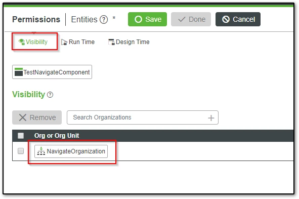

Go to the permission section of you mashup :
Add the NavigateOrganization in the Visibility section.
If the users see the ootb mashup from navigate, this should be enough

Mar 4, 2020 4:24 PM UTC
