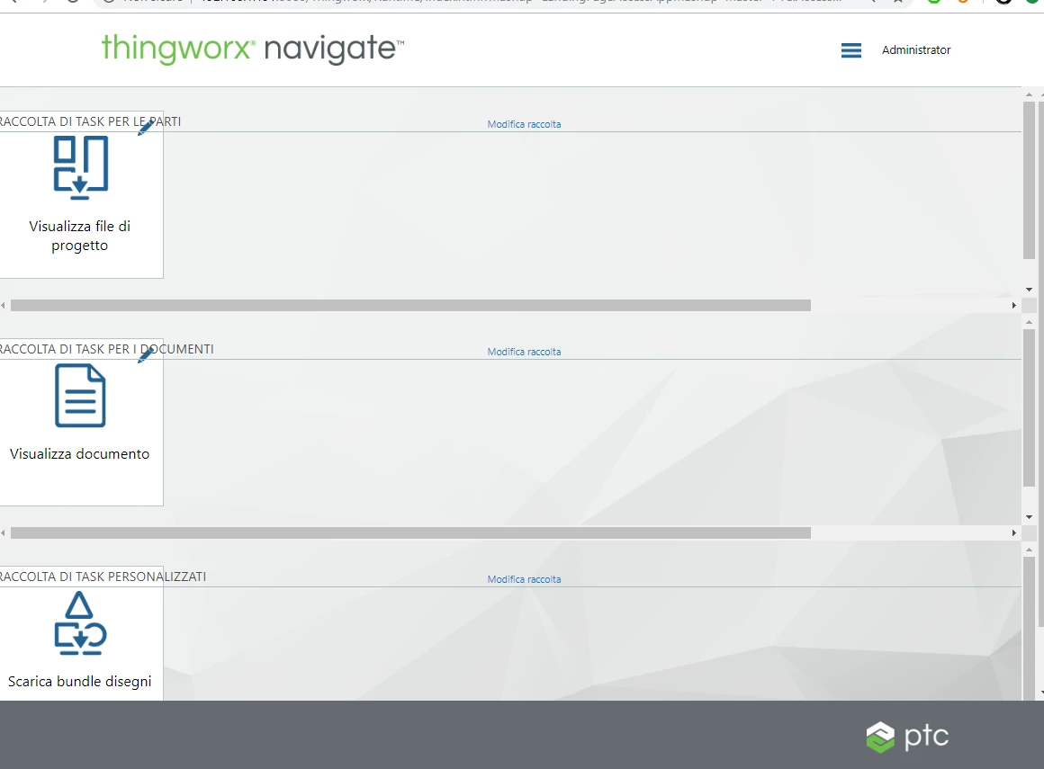

Recently I upgraded Thingworx from 8.1.3 to 8.4 and Thingworx Navigate from 1.6.1 to 1.9.1 following official PTC guides. During upgrade I did not see any errors or failures but now the Navigate Landing Page has serious rendering issues s you can see from the attached screenshot
There are no javascript errors and all static resources (CSS/JS etc...) are loaded correctly
Thank you

It seems that JavaScript files under Thingworx/Runtime
- mashup-common-general-runtime.js
- mashup-common-widget-runtime.js
- etc...
Are not correctly upgraded, ora there is a bug in the upgrade package

I solved the issues copying all files contained in folder  <TOMCAT_HOME>\webapps\Thingworx\Runtime from Thingworx Navigate 1.9.1 clean installation to my upgraded navigate. You are facing same issue on clean 1.9.1 installation?
