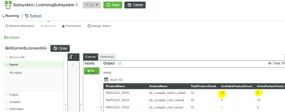

I have 10 licenses ptc_navigate_author_named. But the problem is that I can't use any license

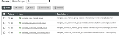

If I see the User Groups, I have not a group "navigate_author_named_group. This group should be created automatically from LicensingSubSystem, is it right ?.
Can someone help me, please?

Version: ThingWorx 8.5.1-b90 "

The 4 license groups you see are the only licenses groups created in Navigate. Other licenses such as the author or adk licenses are paired with the view_named licenses, so the first n number of users assigned to the ptc_navigate_view_named group, where n is the number of author licenses, receive the functionality provided by those author licenses.

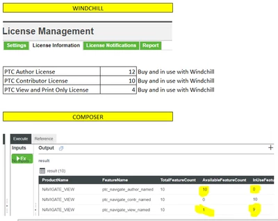

I have bought 12 licenses "ptc_navegated_author", 10 licenses "ptc_navigate_contrib_named" and
4 licenses "ptc_navigate_view_named". In total 26 licenses that should be used with Composer (Navigate).
However, I can only assign 20 licenses to users. Is there any synchronization that I should do between Composer and AD? or between Composer and Windchill?

I am researching the details of how the licensing works, but I think that licenses you have in Windchill will not show up in Navigate.
