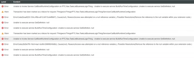

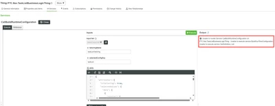

This was a Cache issue; even the mashups were not loading in the composer.
Delete the Temp Files(clearing the work and temp folder in Tomcat) and restart the Thingworx to fix this issue.
