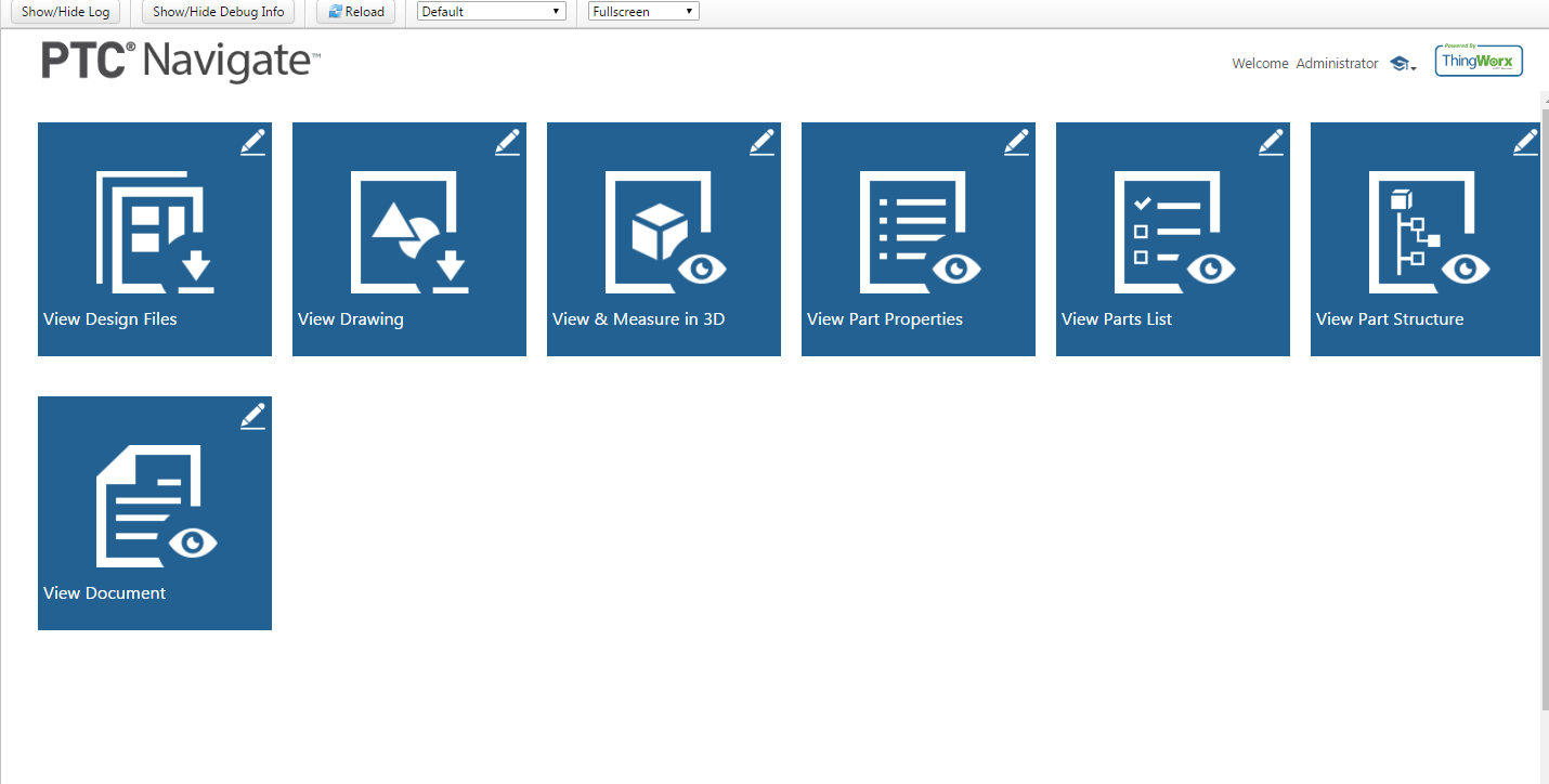

Hi Guys,
I have download the extension.
Install Thingworx 7 successfully,then import navigate extension to Thingworx composer.
I also import the navigate extension for PLM.
Then I open the mashup named "LandingPageAccessAppMashup" which seems like:

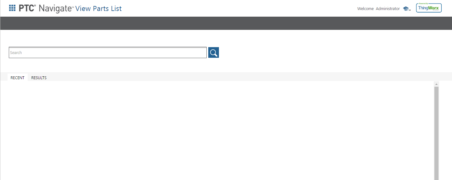

Now when I navigate to any of these tiles like for e.g. take View Parts List the the page comes up is:
Now I have also installed the patch on my local windchill side.
But how would I able to use this functionality.
I gave some part numbers in the box but it says no records exists.

Please check if you have configured correctly the ptc-windchill-demo Thing to specify your Windchill url.
I think good starting point for you would be to explore the PTC Product Documentation for Navigate.
The PTC Navigate User Guide will help you to know about PTC Navigate and what it offers.
Also you can check Installation and Configuration guide if you are facing trouble in connecting to Windchill as mentioned above.
Jul 26, 2016 4:29 PM UTC
Also make sure to follow the install instructions. I remember you need setup a trusted user and same user should exist in both systems. Also there are some issues around using wild cards. It is documented as well.
