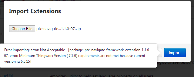

I have been trying to install PTC Navigate on Thingworx 6.5 . The PTCNavigate.pdf guide says the required version is Thingworx 6.5 only. But when trying to import PTC-Navigate-Framework.zip the below error pops up. I do not want to install TW 7.1 as it comes only with PostgreSQL.

Seems the guide you are referring to is old one. Navigate framework extension 1.1 requires Thingworx 7.1.

if you are downloading most recent datecode of navigate app from support.ptc site then in read me file check below link which point out to Navigate guide 1.2
http://help.ptc.com/navigate/1/en/
in this page check below
see PTC Navigate Guide. mention about Thingworx7.1 platform.
