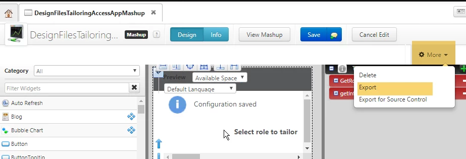

Can you please help me out on how to export the entities ? I mean, which all entities to export. How to export all the custom changes made in Navigate ?

You can export the entities that are customized through ThingWorx Composer UI.
