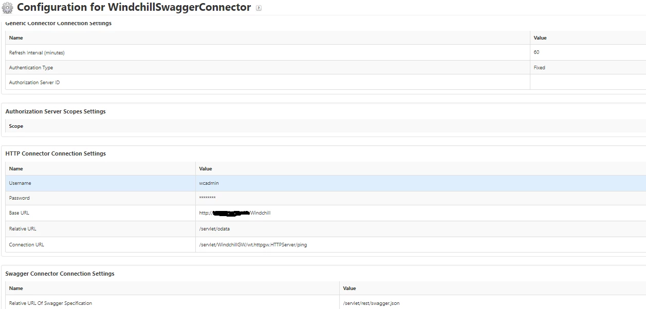

I'm working on PTC Navigate 1.5.0 and Thingworx 8.0.1
I'm having issues similar to this article. The rest.properties file also seem to be proper as mentioned in the article. The configurations on the "ptc-windchill-integration-connector"are as shown in the image
I have observed the following in my composer:
  1. "ValidateConnection" service is giving "Success:200-OK"
  2. "GetEndpointList" service is giving the below error
Unable to Invoke Service GetEndpointList on ptc-windchill-integration-connector : Your route exchange has failed. HTTP operation failed calling [http://<IP>/Windchill/servlet/rest/swagger.json] with status [404 - 404]
    3. When i tried loading the below URL i got HTTP Error 404 page not found.
I have tried reinstalling the patch twice and it was not helping. I can't find any root cause for this issue. Is this related to windchill installation or Thingworx side problem? Please help me out.

HI @SaranKarthick,
It seems like you are using Fixed Authentication with Navigate 1.5, you should be using PingFederate authentication method.
However this issue might not be related to authentication method.
Is it possible for you to share the MethodServer and THingWorx Navigate logs, Along with this, please send the rest.properties file to verify.
BR,
Harsh Selarka

Hi @hselarka,
Thanks for your response. We're configuring the entities without SSO and so went with Fixed authentication.
I have attached the logs and the rest.properties files.

Hi @SaranKarthick,
The error message in your logs is
2018-11-09 11:23:49.676+0100 [L: ERROR] [O: c.t.w.BaseService] [I: ] [U: Administrator] [S: ] [T: http-nio-8443-exec-10] [context: com.thingworx.webservices.context.HttpExecutionContext@2a31434e][message: Unable to Invoke Service GetCommonAvailableAttributes on AttributeSelectorThing : Your route exchange has failed.  HTTP operation failed calling [http://xxx.xxx.xxx.xxx/Windchill/servlet/odata/tableview/nav.list.all/attributes] with status [400 - 400]]
However the error message in article is for [404-404].
What is the error message in IntegrationRuntime logs? Also is there any specific reason you are not using PingFederate Authentication?

Hi @mgoel @hselarka,
Apologies for the late response. We are having some trouble with the server in which Navigate is installed. Once its sorted i'll get the integration run time logs. As for SSO configuration we decided to skip this for the initial phase of the project.
