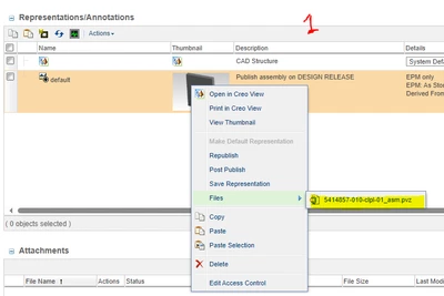

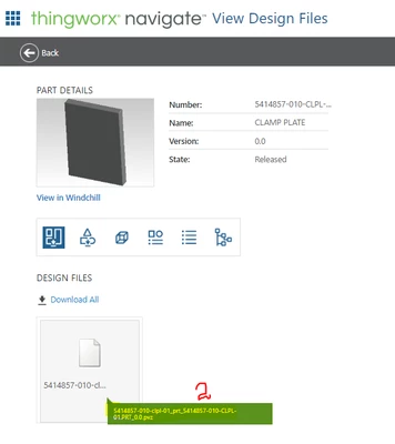

For Example, take a cad part/asm/drw which contain any additional files (1), will appear in the view design files (2)

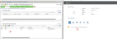

in my case the file is released and doesn't contain the additional files, I need an option to publish the file to get additional files for the specific cad part/asm/drw.
Snaps are shown for understanding purpose with OOTB apps, but we have a custom application built with similar kind of function. we need to implement the trigger/start creating representation for files that don't have the additional files from thingworx.

Getting all file content (representations) from windchill using REST API is currently available but what I need here is that I need to trigger the publishing (create new representation) option from Thingworx side.
