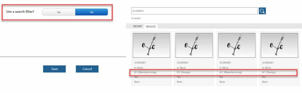

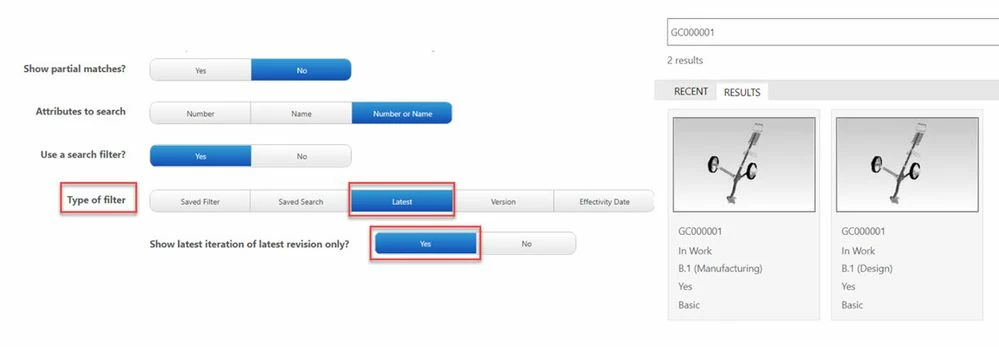

Sep 15, 2020 9:33 PM UTC
Hi Rick,
Here's an example of Tailoring in Navigate for Displaying All Versions and displaying only Latest :
1. Show all versions :
2. Show latest iteration of latest revision only :
Regards
Arshad
