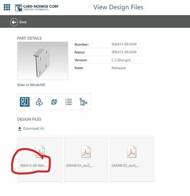

Results Tile format in ThingWorx Navigate
How do I change the tile to allow more of the Attribute text to show.

I'm not too familiar but that looks like a collection widget. So you would have to find the mashup and edit the mashup.
Or if these are locked down, you would have to duplicate all the necessary mashups to create your own custom UI based on those.
