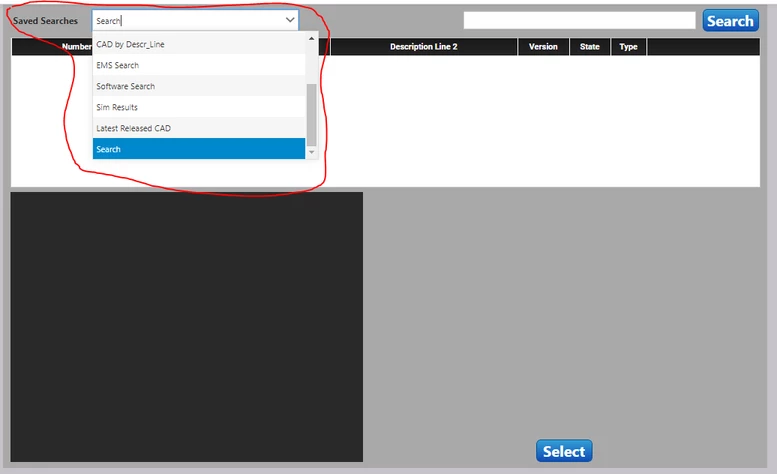

I have worked through the tutorial of setting up a simple search from saved searches.  What I would like to do is default the saved search to a specific one and not have the saved search list visible.
I assume I could call the oid of that search but cannot get that to work.
December 6, 2019
To my knowledge setting a default saved search cannot be done in Navigate. Navigate reads the saved searches in Windchill and populates this list from that. It has no internal record of which saved searches exist, so it cannot flag one as a default.
