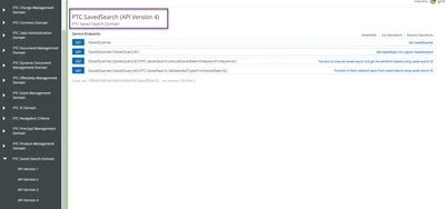

hello everybody, I needs to do a search in thingworx navigate starting from a property saved in a things of thingworx as search field.
I thinks I have to use thingworx flow but i do not know how to do it.
thanks for any response

You can do searches against Windchill with REST calls.
With swagger Example : https://www.ptc.com/en/support/article/CS314207
or with ODATA :  https://<YOUR_WINDCHILL_SERVER>/Windchill/netmarkets/html/wrs/doc.html
Flow is not really needed.
Kind regards.

Hi , unfortunately I don't have access to the link.
I was thinking of flow as the parameter comes to me from Vuforia studio that searches windchill using thingworx flow
thanks for the reply is very valuable

There was typo in hyperlink : see CS314207
Kind regards.
