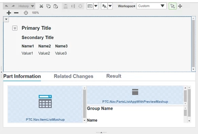

We have been following the CS332905 article to create a custom mashup. As shown in CS332905 article, we have created the simple custom mashup,

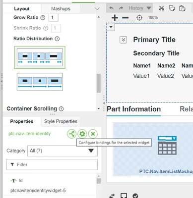

we are trying to configure the bindings for the widgets

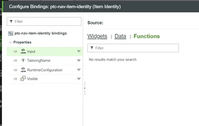

Once we click on configure bindings, the below window will open. in the function tab, some output functions should be available.
In our case the output functions are not available. This is the reason we are unable to fetch the data from windchill.

@RG_10893406 , I have reviewed the article/video which you referenced. You may have missed the configuration of the widget.
Did you click on the Gear Icon ?
This should open the "Configure Item Identity". For the widget which you have selected "ptc-nav-item-identity".
This should allow you to select from the drop down list. I would expect 2 entries "Task Identity" and "Part Identity"
Making that selection should display configuration information. You need this to be completed before you go to the next step which you show in your post of the "Configure Binding: ptc-nav-item-identity"
Please review you steps and let me know if anything changed?
