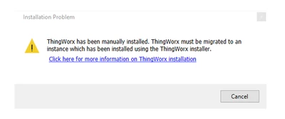

I have installed Thingworx 9.0 instance and running an application. I have installed it manually without using installer.
Based on requirements, I have to install Thingworx Navigate 9.0. when I'm trying to install navigate it's again asking me to install Thingworx foundation using installer. Is there a way to install Navigate without removing existing instance. The server is having only one drive so i can't use two instances also.
Any suggestions on this?

    Navigate installer is looking for a file called :
    C:\Users\<USERNAME>\.ptc_ccif\ThingWorxFoundation.xml
    with content :
    <?xml version="1.0" encoding='utf-8'?> <installationInfo>
        <projectFlavor>MSSQL</projectFlavor>
        <applicationName>ThingWorxFoundation</applicationName>     <applicationVersion>9.0.0</applicationVersion>     <applicationInstallDir>C:\ThingWorxFoundation</applicationInstallDir>
    </installationInfo>
    Please create this file, change vaule in bold accordingly to your current installation and re-launch Navigate installer.

    I have created the file and updated it accordingly, now it threw the below message. Any other changes do i need to make?
    Aug 31, 2020 1:39 PM UTC
    So i think you need to re-install TWX 9.0 with installer. No other solution.
    See https://www.ptc.com/en/support/article/CS327519
