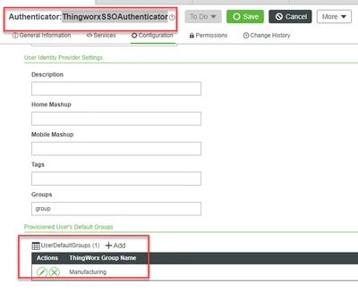

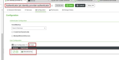

Hallo,
can I change the settings so that every new user automatically belongs to one specific group for Example Manufacturing?
Thnx

If you are using Windchill authentication, as Administrator, Edit Authenticator > ptc-identity-provider-authenticator and add group as below :
If you are using SSO, Edit ThingworxSSOAuthenticator and add group in UserDefaultGroups :
Kind regards.

Apr 29, 2022 6:06 AM UTC
I'm using the same way you mentioned above but when user's belong to different role are also added to the specific group which we added in the ptc- identity-provider.
Is there any way to overcome this?
Thanks in advance!
Apr 29, 2022 7:59 AM UTC
Not sure to understand. Can you clarify use case?
If you define group(s) in authenticator every new user will belong to these group(s).
Kind regards.
vcavic1-VisitorAuthor
Jul 13, 2021 8:08 AM UTC
@schauvelin  Thank you!
