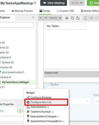

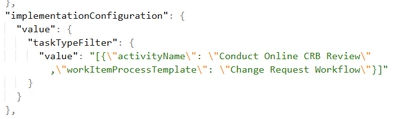

The configuration of the JSON needs to be made to show all the Tasks or the Problem Report Tasks.
  1. Press on the Configure Item List:
  2. Then, change the JSON as  per the Template and the activity name:

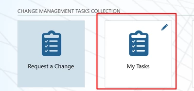

My Tasks is not currently capable of showing the Problem Report Tasks. My Tasks allows the user to see a list of change request review tasks that are assigned to them. The user can select a task to see more information about it and perform the following actions: Approve, Reject, Analyze, and Reassign.
The choice of the name My Tasks for this tile is more of an optimistic plan for the future than an accurate reflection of its current capabilities.
