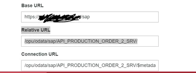

I faced a problem when I tried to establish the connectivity between My Thingworx and SAP,
I already followed the available HandsOn tutorial for the configurations
IR is OK,
SAP Endpoint OK
but connectivity not OK
Then trying to map services in API mapping, I got :
And for IR LOGS :
Any suggestions or solutions ?

Hi @bYoussouf.
Based on the errors, it still appears to be a permissions issue.  Did you test it under the Administrator account--not an account with Administrator permissions?  This needs to be the next step in troubleshooting the issue.

Could you please confirm that "Validate connection" and "GetEndPointList" services are working correctly in your TWX SAP connector?
Can you confirm your Thing is inheriting from SAPODataConnector template?
Are you using fixed authentication? if so, is "Authentication Type" set accordingly?
Kind regards.
bYoussouf1-VisitorAuthor
Mar 9, 2021 4:45 PM UTC
Thanks for your replay,
Of course I used SAPODATAConnector thing template
validateconnection service is OK
But the getendpointList can't fetch the metadata of the URL
