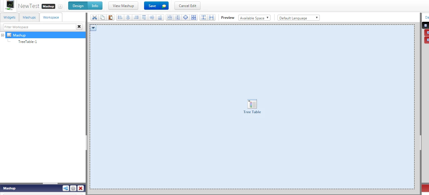

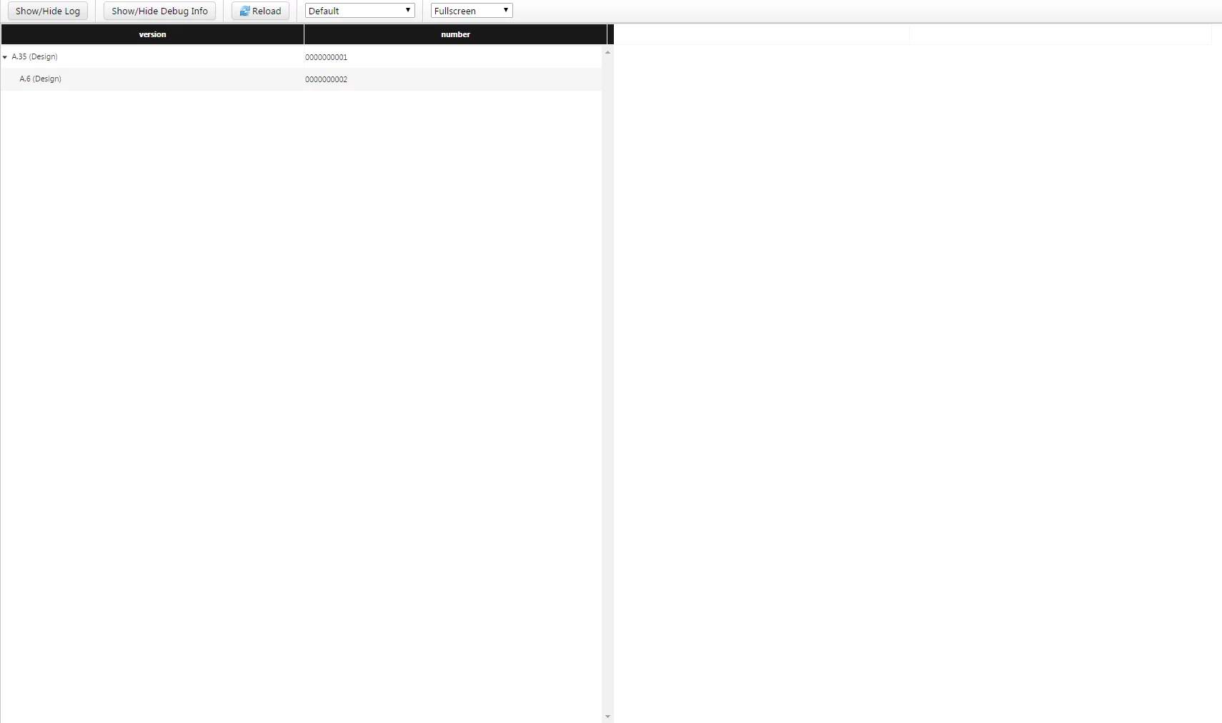

Tree Table widget malfunction
I have a trouble with Tree Table widget which comes from Windchill extension. Wherever it placed, it occupies exactly 50% of available width, even on pure Mashup without any other elements and without any settings at all. Screenshots are attached. If someone knows how to make it occupy all the width, I will be very thankful.

Oct 25, 2016 8:48 PM UTC
This is a bug, Jira PSPT-3029 is filed. It appears to only affect version 7.2. The Jira has critical priority

Jan 19, 2017 5:26 PM UTC
Removing the core-ui and installing the version from the windchill connection extension worked for me (same 2.0.0 version). Appears to be an issue with the core-ui in the Utilities extension.
