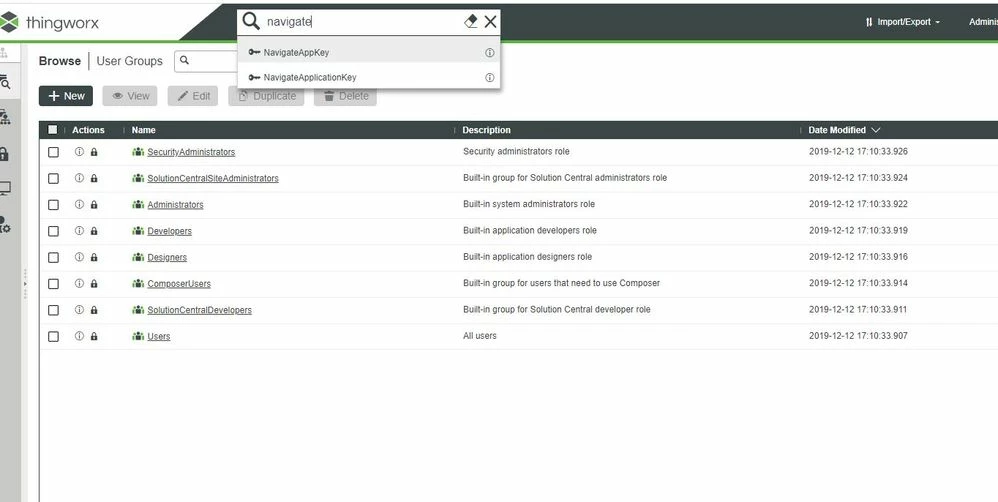

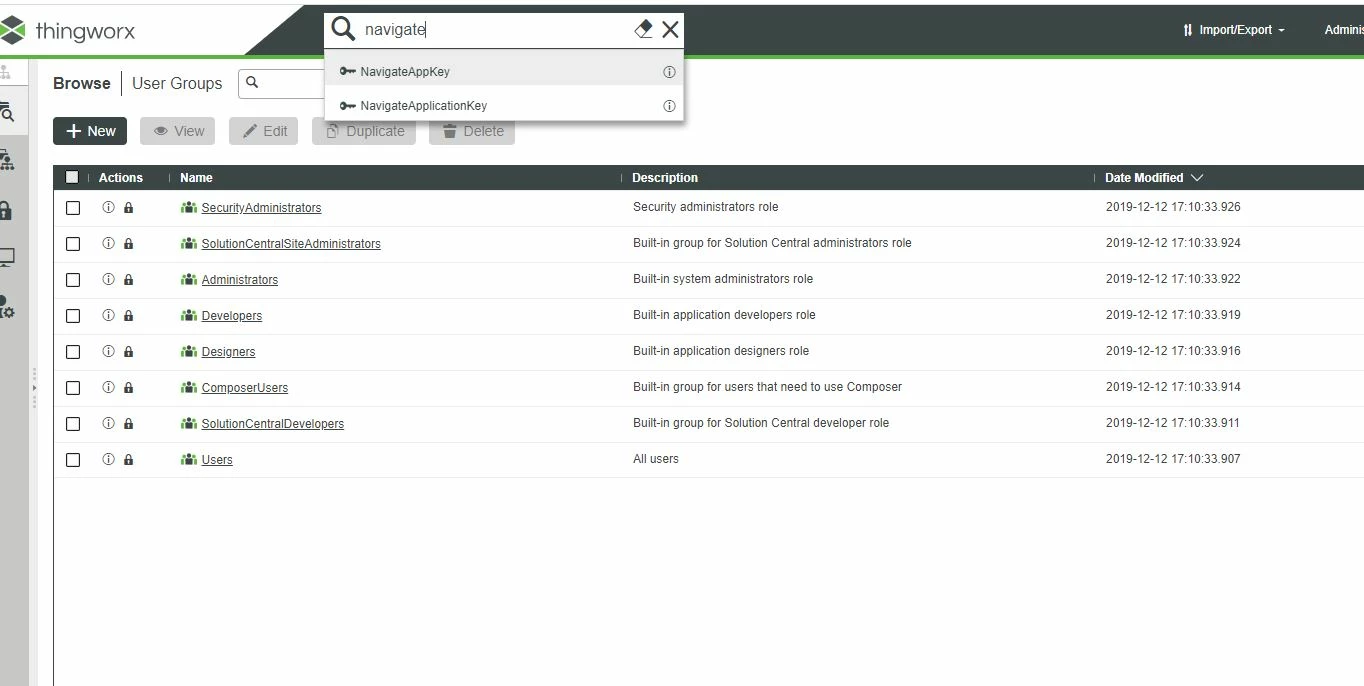

Hi all,
I have installed thingworx 8.5 version.
thingwork composer is working fine but I am unable to open the landing page. even i am not getting landing page mashup?
below I have attached a snapshot of this issue.

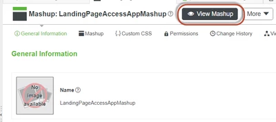

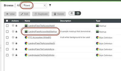

Users with access to Composer can also follow these steps, although they involve more clicks. Search for “land”; click on” LandingPageAccessAppMashup”; click on the black “View Mashup” button:
