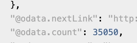

Do you know why the count number retrieved in Navigate's Service is different from the count number retrieved in WRS?

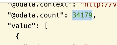

When I created and ran the service in Navigate, I got odata.count: 35050.
But the result of the search in WRS was 34179.
When I logged the url accessed from Navigate and accessed it, it was 34179, so the numbers are different only on the Navigate screen.

This is the code for service.
I am running zuban with "*".
const selectAttribute = "ZUBAN%2CVersion%2CState%2CCreatedBy%2CCreatedOn%2CModifiedBy%2CLastModified%2CFolderLocation";
const commonURL = "servlet/odata/v4/DocMgmt/Documents?%24select="+selectAttribute;
var accessURL=commonURL+"&%24filter=ZUBAN%20eq%20''";
if(zuban!=null){
 accessURL=commonURL+"&%24filter=ZUBAN"+encodeURIComponent(" eq '"+zuban+"'")+"&%24count=true" ;
 if(zuban.length==1){
 if(zuban=='*'){accessURL=commonURL+"&%24filter=ZUBAN%20eq%20''&%24count=true";}
 if(zuban.length>1){
 if(zuban=='**'){accessURL=commonURL+"&%24filter=ZUBAN%20eq%20''";}
 if(zuban.slice(0,1)=='*' && zuban.slice(-1)=='*' && zuban.length>2){
 	accessURL=commonURL+"&%24filter=contains(ZUBAN,'" + zuban.substr(1, zuban.length-2) + "')"+"&%24count=true";}
 if(zuban.slice(0,1)!='*' && zuban.slice(-1)=='*'){
 	accessURL=commonURL+"&%24filter=startswith(ZUBAN,'" + zuban.substr(0, zuban.length-1) + "')"+"&%24count=true";}
 if(zuban.slice(0,1)=='*' && zuban.slice(-1)!='*'){
 	accessURL=commonURL+"&%24filter=endswith(ZUBAN,'" + zuban.substr(1) + "')"+"&%24count=true";}
var headerObject = new Object();
headerObject["Content-type"] = "application/json";
var header = JSON.stringify(headerObject);
var params = {
	proxyScheme: undefined /* STRING */,
	headers: header /* JSON */,
	ignoreSSLErrors: undefined /* BOOLEAN */,
	useNTLM: undefined /* BOOLEAN */,
	workstation: undefined /* STRING */,
	useProxy: undefined /* BOOLEAN */,
	withCookies: undefined /* BOOLEAN */,
	proxyHost: undefined /* STRING */,
 url: me.WindchillUrl + accessURL,
	timeout: 3600 /* NUMBER ,{"defaultValue":60}*/,
	proxyPort: undefined /* INTEGER */,
	password: me.WindchillUserPassword /* STRING */,
	domain: undefined /* STRING */,
	username: me.WindchillUserId /* STRING */
// response: JSON
var response = Resources["ContentLoaderFunctions"].GetJSON(params);
var result = response;	​
This is the RequestURL for WRS.
http://<host-name>/Windchill/servlet/odata/v2/CADDocumentMgmt/CADDocuments?%24select=ZUBAN%2CVersion%2CState%2CCreatedBy%2 CCreatedOn%2CModifiedBy%2CLastModified%2CFolderLocation&%24filter=ZUBAN%20eq%20''&%24count=true

Hi @沙竹_10532172
Are you using the same credentials for both Thingworx Rest Call & Windchill Rest Call?
I can see in Thingworx, you are using the fixed username and password to fetch data from the Windchill system.
