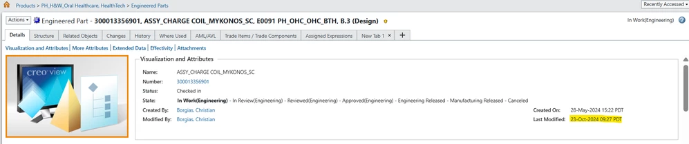

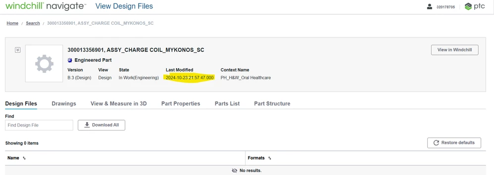

The date time format on windchill details page and windchill navigate OOTB apps search result page is different not in sync.
On windchill details page the date and time format is UTC (The date format was changed from default yyyy-mm-dd to dd-mm-yyyy)
On Navigate app search details page date time format is different its coming IST and date format is still deafult.
Windchill Version 13.0.2.4
Windchill Navigate(Formerly Thingworx Navigate) Version -9.7.0
Can the date time format be in sync at both places?

    I believe that is just a display setting. The time/date is stored in the database in UTC format.
    I know you can set a preference in Windchill to set the time to display in your local time zone. You can also set the display of the date to meet your local preferences. I would thing Navigate would also have some preference for setting date and time to your local preferences.

    Hi @Catalina ,
    We have already raised a PTC case and technical support team upon consulting with R&D team have only asked to raise as idea as currently it is complex. Also, they have created this article Article - CS451268 - Is it possible to change timezone settings of Navigate Mashup in ThingWorx Navigate. I had earlier raised it as topic that's why created it idea under Thing Worx platform
