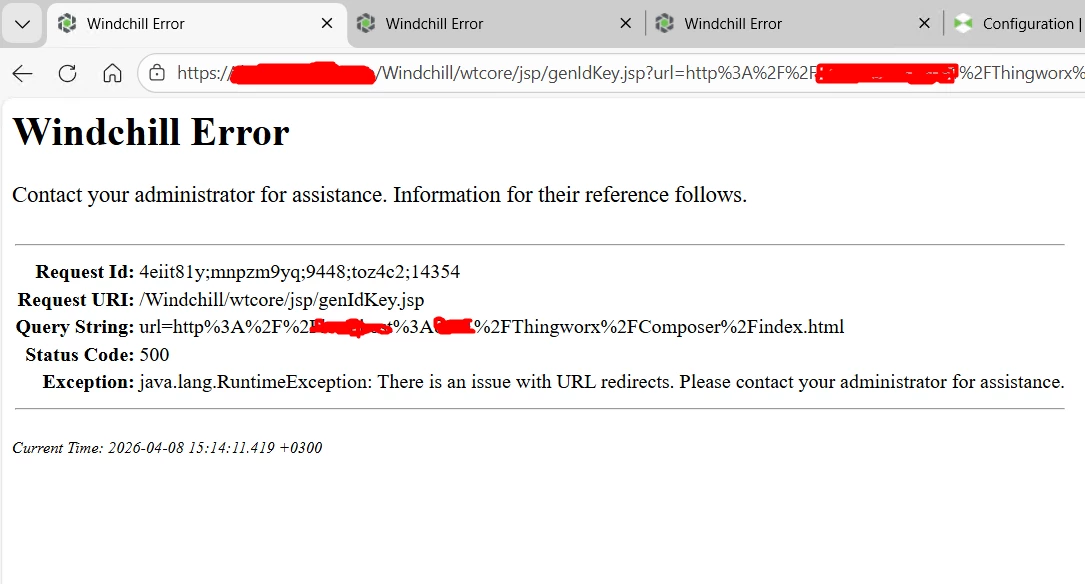

Hello Community,
I have tried to install ThingWorx and Windchill Navigate, but I am facing a few issues. Could you please help me?
  1. When I am redirected through the Windchill address I connected to, a Status Code: 500 Windchill error screen appears.
    I edited the Windchill wtproperties file, but it did not resolve the issue.

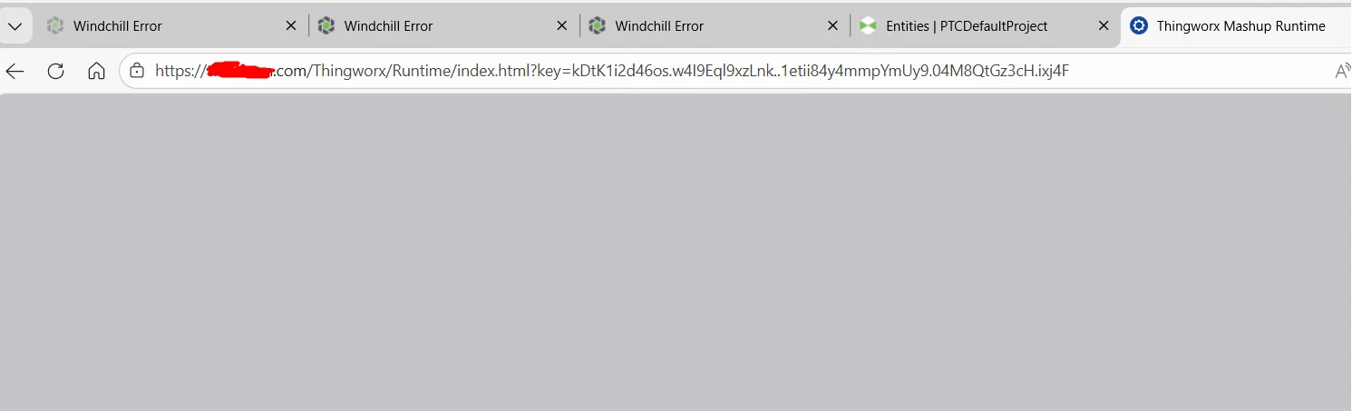

  2. ThingWorx opens successfully, but the ThingWorx Mashup Runtime displays a blank screen.
    What could be the reason for this, and how can I fix it?

Apr 16, 2026 8:29 AM UTC
Article - "User unable to access ThingWorx, ThingWorx Navigate, or SCO (Smart Connected Operations) configured with Windchill Authentication due to invalid URL redirects": https://www.ptc.com/en/support/article/CS327594
