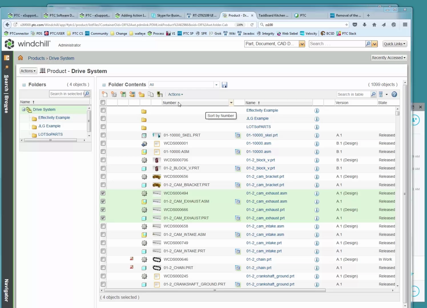

In this example Change Associations are used to define that a Prototype CN (Soft typed) will have a single Change Task - Prototype Change Task that is defined as the default change task for this type of Change Notice.
With Windchill 11.0 M010 and onwards you can define which Change Task types are allowed and created for a type of Change Notice. This is allow followed with Change Task templates. Together this helps to error proof your process and reduce clicks for the user.
