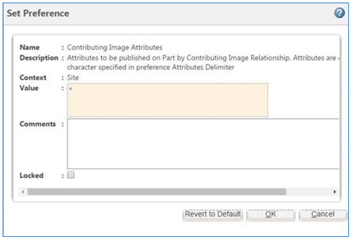

First, you need to establish which attributes you want to pass from CAD Documents to WTPart via the Contributing Image association.  This can be done by setting the Site preference EPM Service Preferences > Build Service Preferences > Contributing Image Attributes to * for all attributes, or you may specify individually using a list of attribute names.  If you do not specify any attributes, then the system defaults to using an Image association instead of a Contributing Image association. In effect, the preference settings in the following figure enable Contributing Image associations in your system.

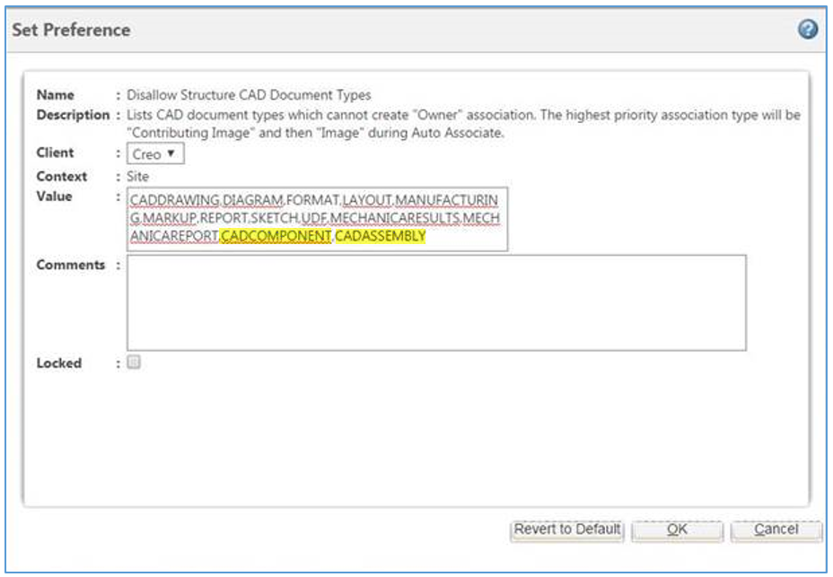

Next, configure the CAD Document types for which you do not want to build structure (disallow Owner associations).  In this example we disallow the building of structure for Creo Parts and Assemblies.  To accomplish this, we add CADCOMPONENT and CADASSEMBLY to the list of types for which building structure is excluded.  This is done by editing the preference Operations > Auto Associate > Disallow Structure CAD Document Types > Creo as shown in the following figure.

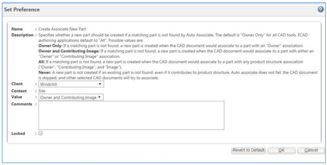

As a final step, If you want to allow Auto-Associate to create parts, you need to set the value of the preference Operations > Auto Associate > Create New Part to Owner and Contributing Image as shown in the following figure. The default is to allow this for Owner association types only.

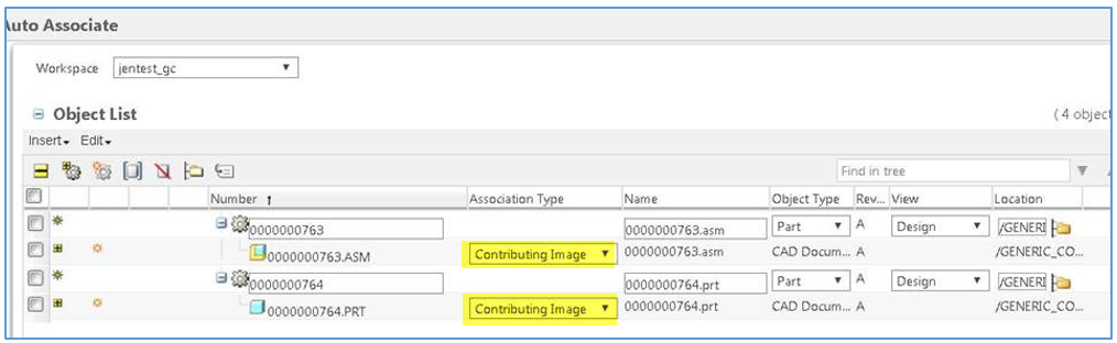

Once these preferences have been set, when you perform an Edit Association, you should be presented something similar to the following.

Step two where you add CADCOMPONENT and CADASSEMBLY to the Creo preference .. the path should say Operation>Auto Associate>Disallow Structure CAD Document Types>Creo.
Also, to change the association type for a large assembly already associated with the 'Owner' type, Add the WTParts to a workspace, Edit Association for all parts, Remove All Associations, and select OK. All WTPart will be checked out. Edit Association for all parts again and all will default to 'Contributing Image'.
