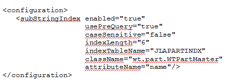

I’ll be adding a substring index for the attribute ‘name’ in the business object class wt.part.WTPartMaster.  The actual creation and maintenance of the substring index tables is done with the SubStringIndexTool, but before running it, it needs to be configured.
The tool reads the configuration file <Windchill>/conf/subStringIndex.xml. This file does not exist in OOTB Windchill, so I’ll have to create it manually.
For this example, the content of the file looks like this:
The parameters className and attributeName are set to the class and attribute on which the substring index is created. I want the index table name to be JLAPARTINDX; if this is not specified, it will default to <table>$<attribute>$SSI, which is a bit long for my taste. I don’t want it to be case sensitive (caseSensitive=”false”) and the index length is set to 6 (indexLength=”6”). I’ll cover that later when we look at the results.
I’m also enabling pre-query, which is one of two available approaches for applying the substring index during searches. The one chosen here means that Windchill first queries the substring index table for matching object IDs; these are then used to query the actual business object table. There are more details on this in the JavaDoc of the wt.pds.subStringIndex package.

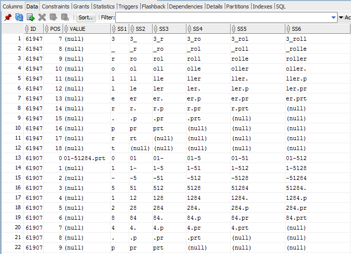

where <user> and <password> is the Windchill database schema username and password. The result is a new table that looks something like this:
The ID column holds the object ID of the related WTPartMaster; the VALUE column holds the full values of the selected ‘name’ attribute. The SS* columns hold the substrings of the given lengths that have been found in the attribute values. This is where the ‘indexLength’ parameter comes in; it was set to 6, so it will generate six SS* columns. SS1 holds all substrings of length 1, SS2 holds the ones with length 2, and so on.
For example, one of the attribute values is '01-51284.prt'. The substrings for this value start in row 13 above: as the POS value increases, you see the various length substrings for that value in the different SS* columns.
So how does it work? Say a user does a search for *5128*. The substring between the wildcards is four characters long, so a fast, indexed search is done in the SS4 column for the exact value 5128. The query returns the ID column values, which are then used to find the matching entries in the original WTDOCUMENTMASTER table.

2. That's an interesting question. First of all, you get one table for each selected type/attribute pair; for example, if you create substring indexes for the NAME and NUMBER attributes of parts, you get two substring index tables, one for each attribute. The size of these tables depends very much on the length of the row data of the chosen column as well as the chosen length of substring.
For example, in my case in the posting, I created a substring index on the 'name' attribute with a chosen substring length of 6. You can see the resulting substring table in the screen shot above; you get one column for each substring length (1 to 6) and effectively one row for each character. If we look at the name value of '01-51284.prt' in the table above, this is 12 characters long, so we get 12 rows with substrings of length 1 to 6 for each of the 12 positions, if that makes sense. This means that we can at least estimate the size of the SS* columns in terms of how many characters are stored.
In the example, the sum of characters in the SS* rows is 6+5+4+3+2+1 = 21. This can be viewed as a triangular number, so can be calculated with the formula (len * (len + 1) / 2) = 21. We get some empty row values towards the tail end of the substring as you can see in the screen shot, but the space is still allocated as the column type is a fixed number of characters(the Oracle column type is CHAR(n) ).
I can then count the total number of characters that will be stored in the SS* columns with the following SQL query:
     select sum(21 * length(name)) as tot_size from wtpartmaster;
This yields 173316 characters in my case. I use multibyte character sets in my database which uses three bytes per character, so the size in bytes is then 173316 * 3 = 519984, approximately 500k. There is some additional overhead from the VALUE column, which is essentially the sum of characters in the original table and column, around 8000 in my case. The bulk of the space is taken up by the SS* columns though, so the sum of those should give you some idea.
So, the main deciding factors in how big the substring index table gets are:
  • The length of the strings in the original table column
  • The chosen substring index length
The latter has a big impact; for example, in my case, the projected character count for the SS* columns are 86658, 173316 and 291486 for substring index length 4, 6 and 8, respectively.
I hope this helps; the formulas above are a bit crude and could do with some refinement to improve the accuracy of the estimation, but it should give you some idea.
