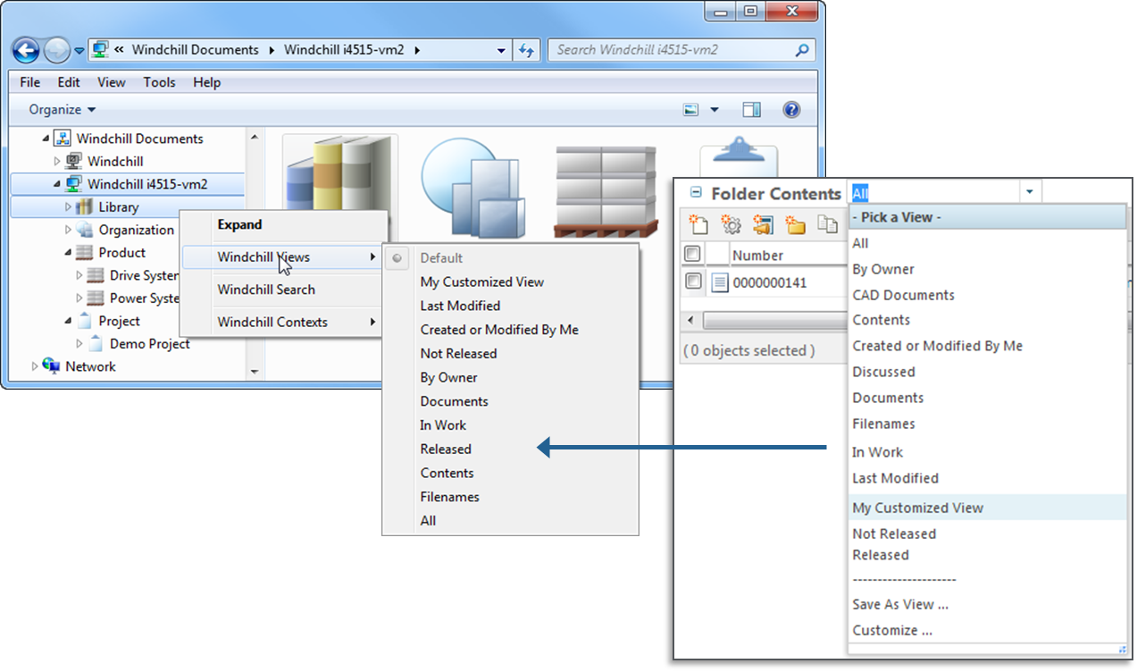

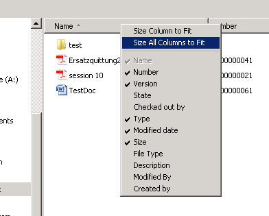

To do so, you have to navigate from the Windchill Documents node to the context that you are interested. On the right hand pane you will see the stored documents.
You may add or remove attributes by right-clicking a Windows Explorer column heading to see a drop down menu of additional columns available.
Is the attribute still not available in the out of the box list?
No problem, since Windchill 10.2 F000 you can select Windchill folder views to add columns that appear in the list. With Windchill 10.2 M010 even the filters on these views will affect the data displayed in the object list.
This allows you to configure which documents will be show in the folder. E.g. if you only want to display the latest document version, then apply filter settings on the Windchill table view (in the Set Filter step select Revision and Version attributes and set them to Latest).

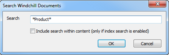

Starting in Windchill PDM Link 10.2 F000 you can search for any Windchill document using the Windchill Search action. This is a quick and easy way to search for your documents inside of the Windows Explorer Integration without the need to open the Windchill web application.
The search can be initiated from context, container or folder level within the Windchill Documents node. This will allow you to search by Name or Number on this context level and all sub-contexts.
Please note that the search is case-insensitive and wildcards are allowed. Add asterisk (*) as a wildcard character to indicate that one or more characters can appear in that position.
For Windchill systems with Index Search enabled, even document content will be taken into account when calculating the results if the option β€œInclude search within content (only if index search is enabled)” is selected.
The native Windows Explorer search field (in the top right corner of the Windows Explorer) can also be used to perform a search but this will yield slightly different results. The search will only be performed on the current folder / context and not on any sub-context.
In case you are also interested in the location of document in the folder structure, you can use the right mouse button menu to select β€œOpen File Location”. This will open the Windchill context or folder in which the object is stored.

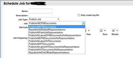

One of the main reasons for this article is to provide a solution to publish from a list of objects.  The ability to publish the defaults as shown in the picture below should remain in tact as additional options. (these don't work for us!)
I'm hoping the process Gary has outlined can be an option for every company that is trying to generate lightweight images.  Basic steps:
  1. Search for the objects or utilize the power of a queryreport.
  2. Take this list of objects found and send them to the publisher for generation of lightweight images.
