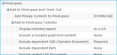

  • Set optimal collection preferences for common operations via Preference Management
Set defaults for operations like Add to Workspace, Check Out, Check In, Revise, Save As, etc. to collect minimal dependencies (None or Required):
If users need different default values, they can make changes in personal preferences or in the Basic/Advanced collectors when performing the operation.

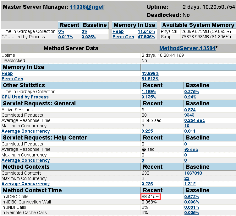

  • Periodically review and monitorSite > Utilities > Server Status for high percentage of Method Context Time is spent in JDBC Calls or PTC System Monitor (PSM) to determine if a high percentage of time is reported as being spent in the database (if there is a suggestion that the database is performing poorly):
Here's an example of Server Status showing a large amount of time in JDBC (database) calls:

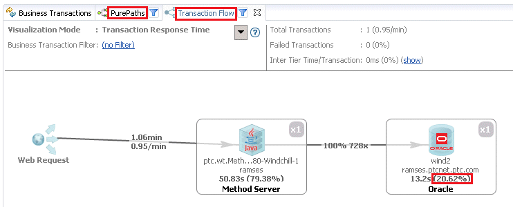

Here's an example of PSM showing a much smaller amount of time spent in the database for a user transaction:

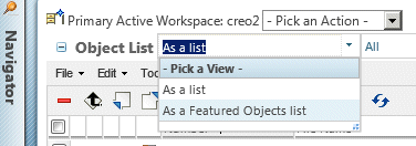

One more question: filtering objects in Workspace with "Search in table" does not really improve Workspace performance (refresh+synch). Is there an explanation for this?
Jochen
CraigPater
20-Turquoise
July 30, 2015
Jochen,
Search in table is a post refresh action (eg. you request an update/refresh of the workspace, the server/client processes the request and then the client filters the content of the workspace based on your "search in table" criteria).
I would instead suggest you use the "As Featured Objects list" functionality:
It acts as a client filter reducing the amount of information the client and server needs to process.
Craig
