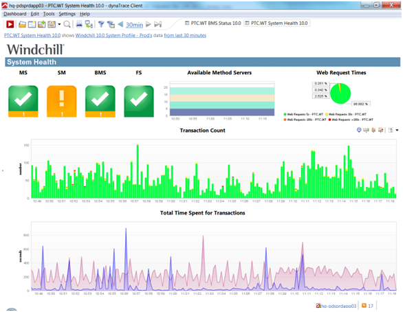

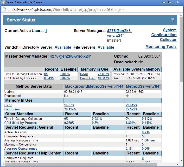

  • Monitor your server – use PSM if possible, or the out-of-the-box Site > Utilities > Server Status page. As a server administrator, keep the page (or an overview dashboard if using PSM) on a screen and check it regularly. This will make you familiar with the day-to-day load cycles on the server, including how user activity rises and falls on a daily basis and when background activities usually kick off. This makes it easier to spot unusual patterns that may indicate budding problems early.
    • Server Status page:
    • System Health dashboard in PSM:
