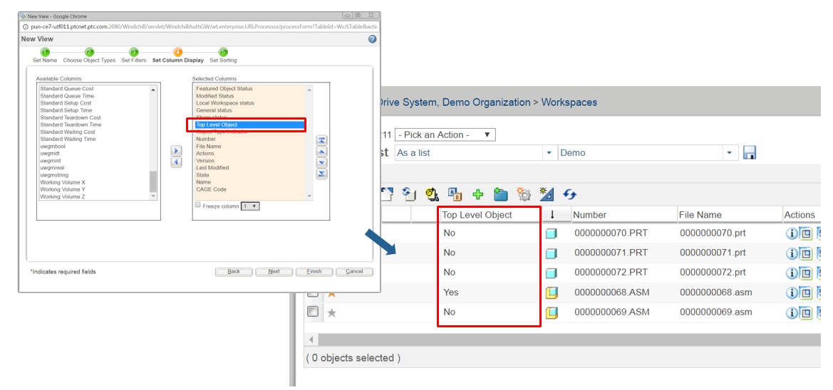

Top-level object column
There is a new column display named “Top Level Object” which indicates whether an object is top-level object. You can customize a more comprehensive object filter by combining Top Level Object column (e.g. display featured top level objects)

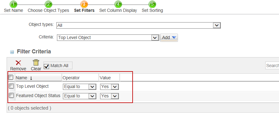

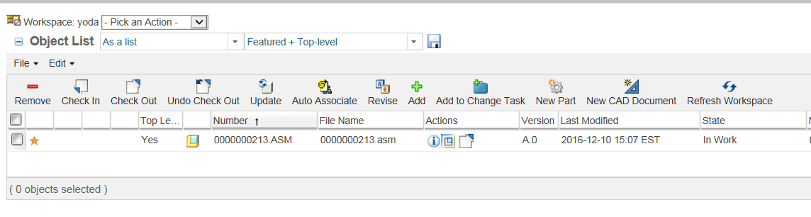

    In order to get a combined workspace view (featured + top-level object), here is the procedure to create a custom view in workspace
    1. From “Pick a View” drop-down UI, click “Customize…”
    2. Create a new view by save as an existing view (e.g. All)
    3. Give a name for new custom view (e.g. Featured + Top-level object)
    4. Click the “Set Filters” from Wizard process
    5. Add “Top Level Object” and “Featured Object Status” from Criteria
    6. Set the operator and value correct, here
      • Top Level Object Equal to Yes
        7. Click “Finish” button to complete the custom view creation
        8. If required, the workspace table will be refreshed
