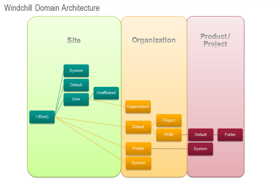

Understanding Domains and Access Control
Windchill system behavior is based on a context or container model. The site context represents the system as a whole, whereas an Organization is a component of the Site and Products, Libraries, Projects and Programs are part of the Organization.
Each of these contexts uses a cabinet to store data and system objects.
Cabinets are associated with Windchill objects called Domain which store policies and access rules.
The chart below illustrates the default Domain Architecture; for a more detailed description please view article CS212423 in our PTC Support Knowledge Base.
Domain structuring in conjunction with inheritance enables general policies to be applied at higher domains and more specific policies to be applied at a lower level.
When debugging Access Control you not only have to consider inherited policies from higher contexts, but also keep in mind how Windchill will evaluate Security Labels, Access Permissions on Groups and individuals as well as Ad-Hoc Permissions.
