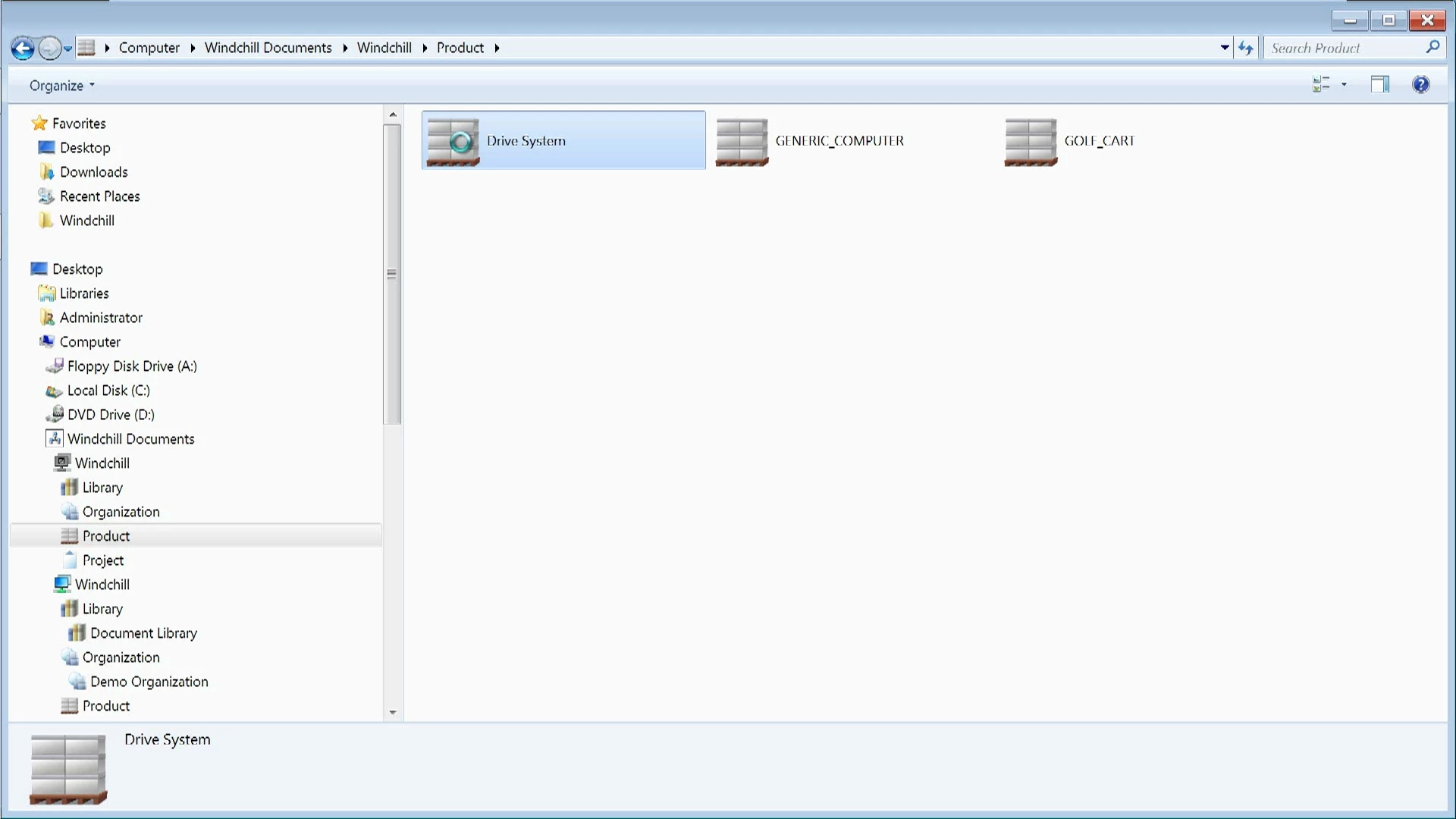

This video highlights many of the new features and capabilities available with Windchill's Desktop Integration (DTI) and Windows Explorer. Watch the video to see all the exciting new capabilities such as simplified connection, container filtering, Windchill actions in the Right Mouse Button (RMB) context menu, detail view configuration, sorting and filtering, drag-n-drop updates, simple and indexed search and the new document comparison.

How the accept Changes and review changes options inside word document feature in MS Word will work along with windchill (Which is showed at end of this video).

Accept/Reject changes is a built-in function of Microsoft Office. Support for all version of Word and Excel and PowerPoint at 2007. This interface is invoked when you run the Compare action. There are many scenarios to consider, but whether you need to update your local docuemtn with updates on the server or vice-versa, the comparison will let you run the visual check and also incorporate the changes in either direction for the document. Once modified and saved locally, the document can be checked back in as a new iteration.
