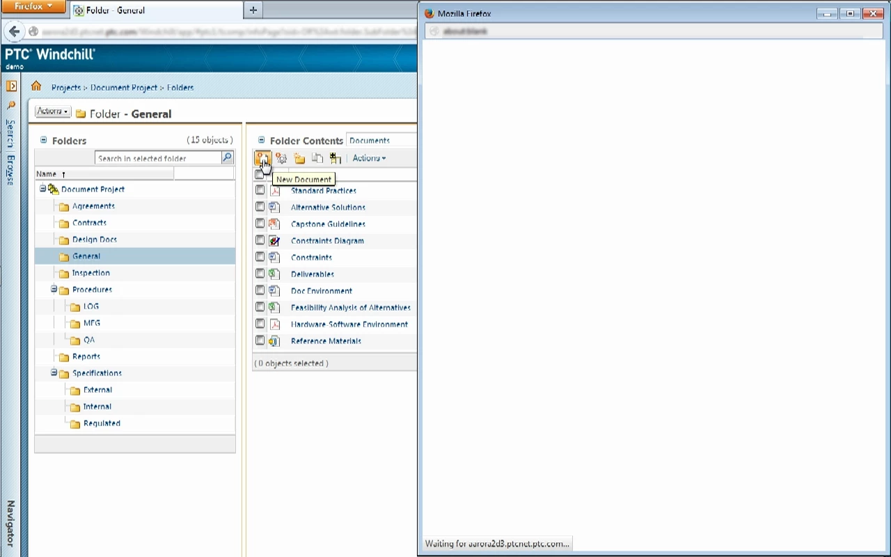

Windchill 10.2 Drag-n-Drop Single Document Upload
PTC is happy to announce the new HTML5 based drag-n-drop file upload utility with Windchill 10.2_M020. This new utility will replace the existing Java based drop target and give people a much simpler and more intuitive way to upload new documents and attachments. This video demonstrates how easy it is to create a single document and its associated attachments using the new drag-n-drop upload utility.

this functionality doesn't work with ie (tested with 10 and 11).
Also with the updated 10.2 software matrices that ptc released in june 2014, it is stated that this functionality is not supported with ie.
What is the plan for this?
sm_011-VisitorAuthor
Jun 13, 2014 11:42 AM UTC
Yes, this is correct. Internet Explorer is not supported for this capability yet. PTC is working to resolve this issue with IE in 10.2 M030.
Even though IE 11 supports HTML5, there are some issues in Windchill preventing it from working as expected. PTC has documented this in the Software Matrices reference document (page 22) and a Technical Support CS Article.
