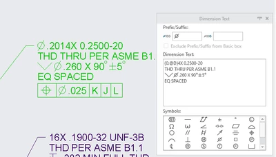

{0:@D} added to annotation
When dimensioning a threaded hole Creo is adding {0:@D} to the front of the dimension. I have tried to delete this several times without results, creating a new dimension for the same hole does not help the problem
Does anyone know why this is appearing and how to stop it from automatically adding
pausobAnswer
Apr 29, 2024 8:14 PM UTC
You will have to change the @D to an @O (the letter O, as in Override) to suppress the display of the dimension value.
Note that only works for annotation dimension.  Driving dimensions cannot be "overriden".

"{0:***}" typically signifies that the enclosed text has a different format that the default for the note.
What version of Creo are you using?  Can you add a screen shot of the dimension and dimension text?
Apr 29, 2024 6:23 PM UTC
Creo 10.0
Dale_Rosema
Apr 29, 2024 6:30 PM UTC
If you add a space between the right bracket } and the 4X, I think the .201 will go away.
kdirth
Apr 29, 2024 8:39 PM UTC
After trying a few things in Creo 7, I think the issue is no space after the dimension.
The @D refers to the dimension.  When you don't leave a space you are trying to append a character to the end of the @D.  To maintain the dimension, Creo is adding the brackets to separate the @D from the added text.
If you copy all of the added text, deleted it and select off the dimension, you can go back in, add a space and paste the text back.  If you don't want a space, you are stuck with the formatting brackets.
