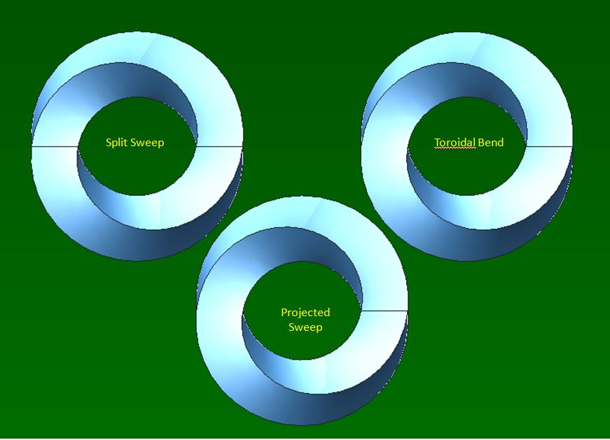

Hi, all. I just realized there is a problem in Creo in handling 180 rotation while sweeping along a circular section. I was trying to create a Mobius with 180-deg twist but the sweep feature failed miserably. After many attempts, I managed to model out the geometry through a few different ways:
1. Toroidal bend.
The sweep is done through a straight line before bending it to 360-deg by Toroidal bend.
2. Split sweep.
Sweep is performed twice, along  half circle each time.
3.  Projected sweep
The single trajectory is extracted from a helical sweep created prior to it.
I am sure many of you have come across the similar problem before. I am attaching my proe file here with the hope that I can learn your workarounds  too. Many thanks in advanced for your sharing.

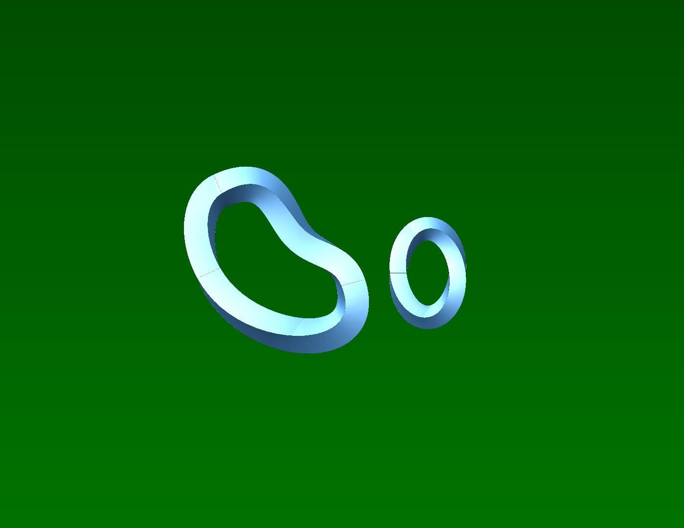

As I explore more into this 18-deg twist, I found that the sweep feature will fail as long as the trajectory is a closed contour. For irregular contours, other than circular, Toroidal Bend can't be used to create the twist geometry. Only method 2 & 3 mentioned above are capable, as shown in the examples below:
Anyone has any explanation on why 180-deg twist fails on the closed contours ? Any different workarounds ? Appreciate you can share your thoughts. Thanks again.

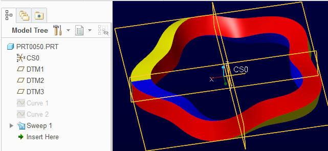

January 3, 2016
I used a rotational blend ( found under the shapes group)
I needed to follow a few simple rules
1. the rotational blend must have a common axis of rotation for all of the sketches
2. all sketches must have the same number of vertices
3. the rotation for all of the sketches must not exceed 120 deg. between sketches
you can pre-define the sketches ( external to the blend) or define the sketches on the fly (internal to the blend)
under the options tab you can specify if the blend is to be a closed loop
look at the attached file  I took your file and created a fourth option for you to decide on

Thanks, Leif Nelson. This could be another to model the geometry. We probably need to fine tune it a little to get more uniform twist.

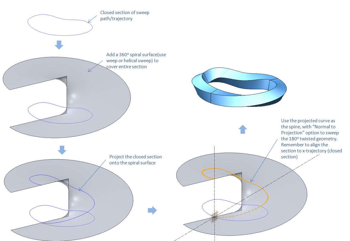

January 6, 2016
January 6, 2016
I might have found a simpler way to generate that trajectory, but this accomplishes the -original- goal.
Method 3 is something completely different!
