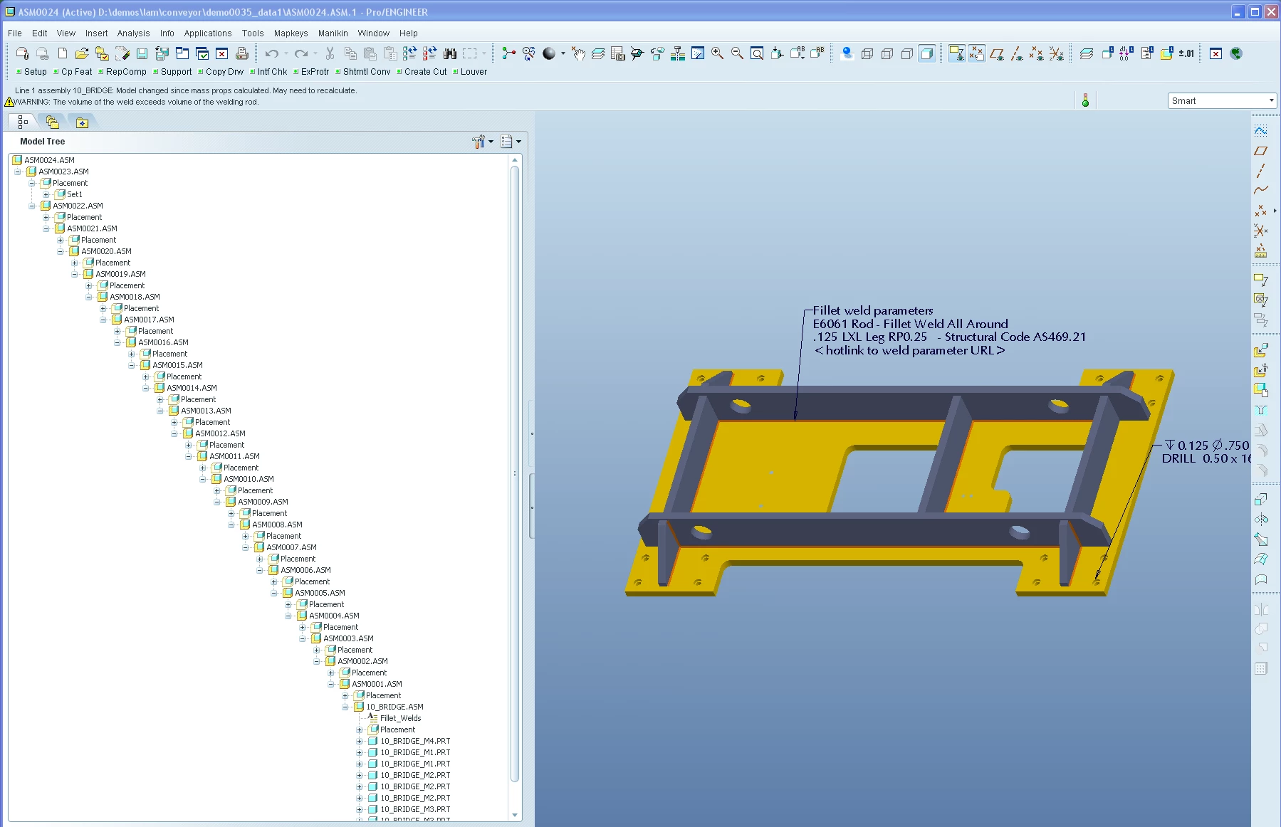

Has anyone come up against an issue when working with an assembly file to the 24th level and beyond? It appears that Pro/E won't go beyond 24 sub assemblies deep. You can't select features by picking on screen or model tree past the 24th level. Any experiences, thoughts, work a rounds?
.asm1
.prt1
.asm2
.prt2
.asm3
.prt3
.asm4
.prt4

Tim,
In Pro/TOOLKIT, the data structures for assembly depth have 25 elements, at
least through WF5. I would think this is a hard limitation in the current
Pro/E.

I created an assembly 25 levels deep, using WF5.
If I add one more level, upon selecting an element in the model tree, proe
(xtop) crashes to the desktop.
Looks like a limit in the code somewhere.
I tried this using WF5, datecode M020.
Not much help, but I can confirm the issue.

The limit on depth of assembly is a matter of judgement and specification. The crash on violating the limit is sloppy coding.

So, I'm curious (but not curious enough to actually try it), is this an
actual limit on the number of levels in the assembly or a limit on the
depth of what you can access within an assembly? In other words, can I
create an assy with 100 levels as long as I don't try to edit a feature
or component, from within it, father down than 24? I can always open
the sub assys and change things from there.
What happens if you create a 24 level deep assy and assemble it into
the 23rd level of another assy?
