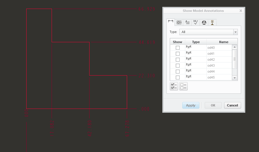

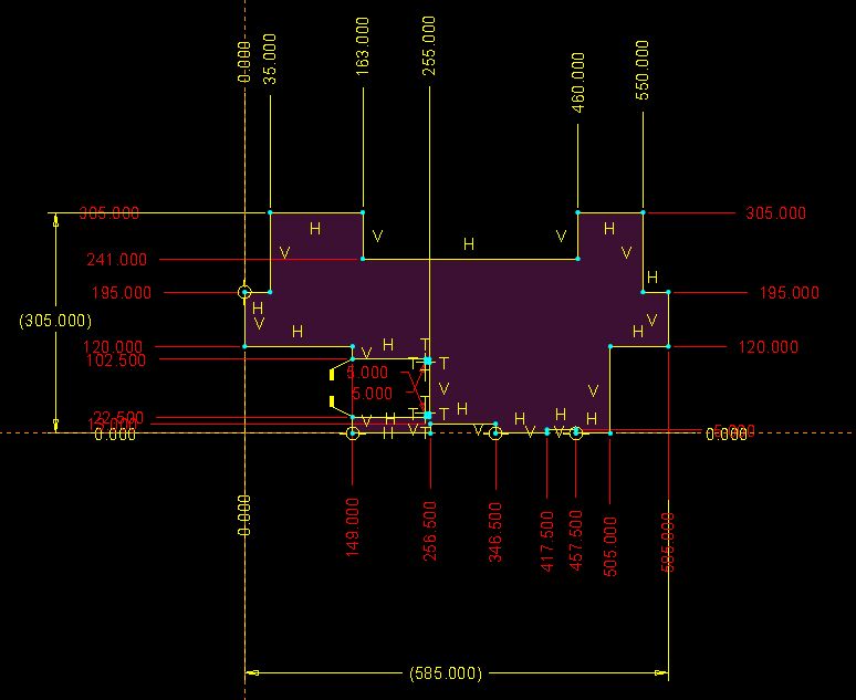

When we created dimension inside Sketch by an each extrusion for ex.
If this dimension has been create with sketch icon "Base Line" and next with skecth icon "Dimension" (see next image)
And the result is:
Why this dimensions ordinate aren't shown as 3D annotation in model?
Instead, linear dimensions, if are shown.
Please, somebody would help me.
Is a configuration?

Even though the icon shows linear dimension, if the sketch was made with baseline, they will be displayed in the drawing.

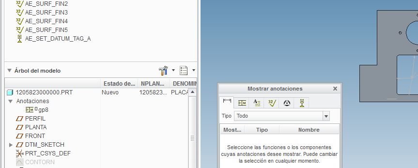

I need show this sketch ordinate dimension, not drawing, if inside 3D model with 3D Annotation

That's a very good question. I do not use 3D annotations but I tried it and you are right. I can not show ordinate baseline dimension from my model as a 3D annotation.
Maybe someone who uses model annotations has a good solution.
