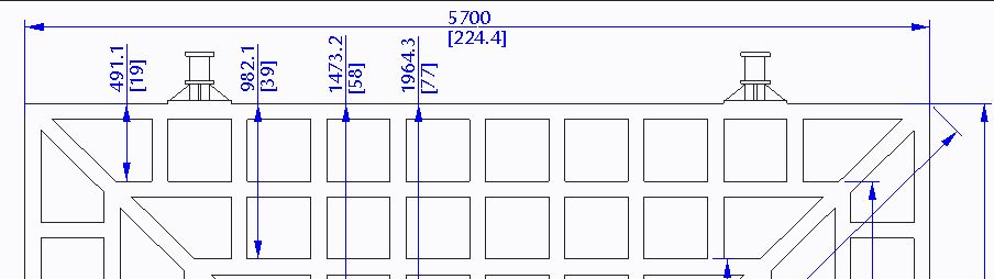

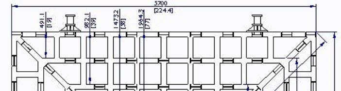

Refer below screen shots
1.) view Dimension are in Blue color
2.) view final export to pdf Dimension color changed to Black color

colors applied during PDF export are defined in pen table file.

Hello Deepak G  ,
see following config.pro option:
pen_table_file  --- Specifies a default pen mapping table which supersedes other pen mapping informations.
Pen table is a creo parametric file with *.PNT extension.
See attached file with example of pen table file.
Regards
Milan

Hello @Milan Bonka,
1.) where i need to save this pen.pnt file in which location.
2.) pdf_use_pentable yes ; im already configured but in default pen table, and location for this i can't find.
3.) I required as per Graphical area shown after export.
all this questions what i need to do.
May 24, 2016
you can save pen.pnt file in any directory, for example C:\PTC
Following options has to be included in config.pro file:
PEN_TABLE_FILE C:\PTC\pen.pnt
PDF_USE_PENTABLE  YES
MH
