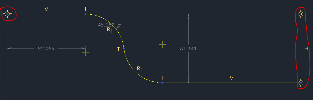

Sketch 1
  • A line and two arcs sketched on the Front plane.
Sketch 2
  • 2 lines and 2 arcs sketched on the Top plane.
  • Note:   The endpoints of the sketches are colinear, but they
    do not have to be coincident.  In other words, they should be
    the same length, but they do not have to touch.  However, the
    feature will still work, but with gaps in the 3D curve.

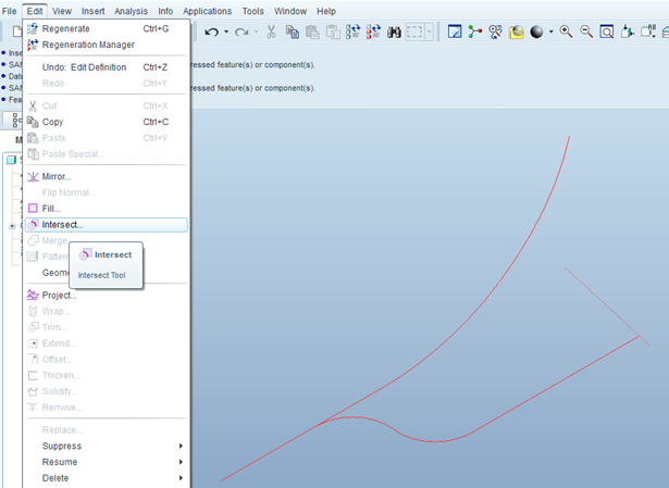

Intersect
  • CTRL select both sketches, then choose Edit>Intersect.  No dashboard menu
    will appear, there will be an instant 3D curve.

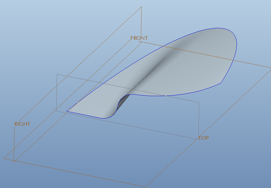

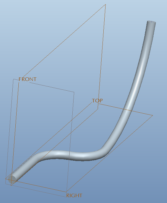

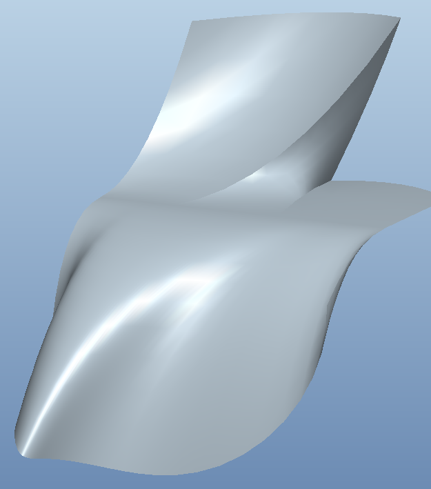

  • The following images show the curve being used for sweeping a circular section and creating a Boundary Blend.
    Note: an additional curve was used to create the Boundary Blend.

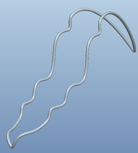

This tool is a lot of fun to experiment with, try it out.  It works with closed sketches, too!  Here are
a couple more examples.  The first one uses a closed and an open sketch.  The other uses two intersected
curves and a sketch for a 3-chain Boundary Blend in one direction.
