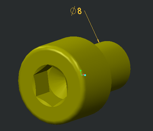

I am having issues with propogating 3d dimension into drawing mode in creo 2.0.
As you can see I have a nice 3d dimension in modelspace(top) but when I try to show it in drawing mode(bottom) it appears linear and doesn't look much like a diameter dimension.I have enabled all config options but still not working. Am i missing something?

have you set the drawing option "allow_3d_dimensions" to yes?

thank you, working now
