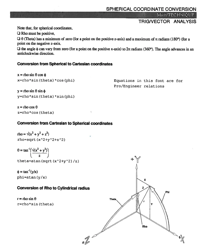

This is from a document I created many years ago. Essentially you need to define your points from the center of the sphere in spherical coordinates. You can use the equations on this page to convert between Cartesian and spherical coordinates.

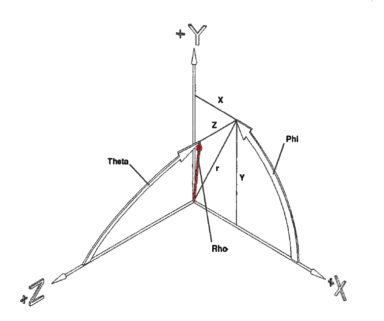

February 18, 2015
I saw it might be easy to miss the Rho vector in the illustration so I filled it in with red.

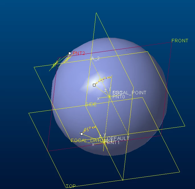

February 18, 2015
Another possible way is to position points relative/offset to a CSYS. See attached file. Pnt0 and pnt2 are part of a table of points that are positioned to a csys via radius of sphere and angles to x and y planes. Pnt1 was created at the intersection of the sphere surface and two planes.
