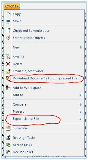

One thing I found interesting is that certain actions pull the full data set, not just the first 2000 displayed items. I know this includes "Download Documents To Compressed File" and "Export List to File". I'm not sure what else works this way.
